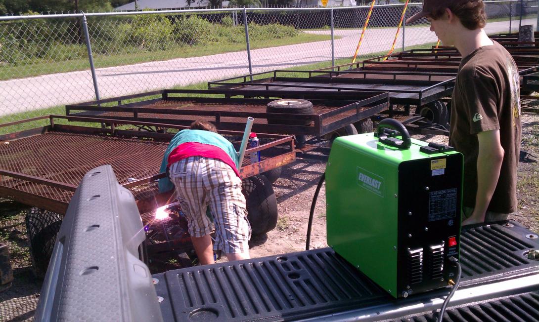

    Dad snapped the picture so you can not see all the trailers surrounding us or the generator. I fix their golf carts, gator mules, trailers, and more. I need the cash to fix my new truck. Lift tires rims. Normally we haul a couple at a time and weld them. Last trip and this trip we loaded up my truck and did them there and saved a lot of time.
    I am using an IMIG-200 with a porter cable 5500 watt generator and flux core .030. Using flux core since it is outside
    I am posting this since people ask about Everlast MIGs and flux core and generators.
    We do not run the TIGS on generators since they are small generators but the MIG-200 and smaller unit work fine. Plus a TIG would not work well outside and take too long.

    Something went wrong with the pics, they're not showing.
