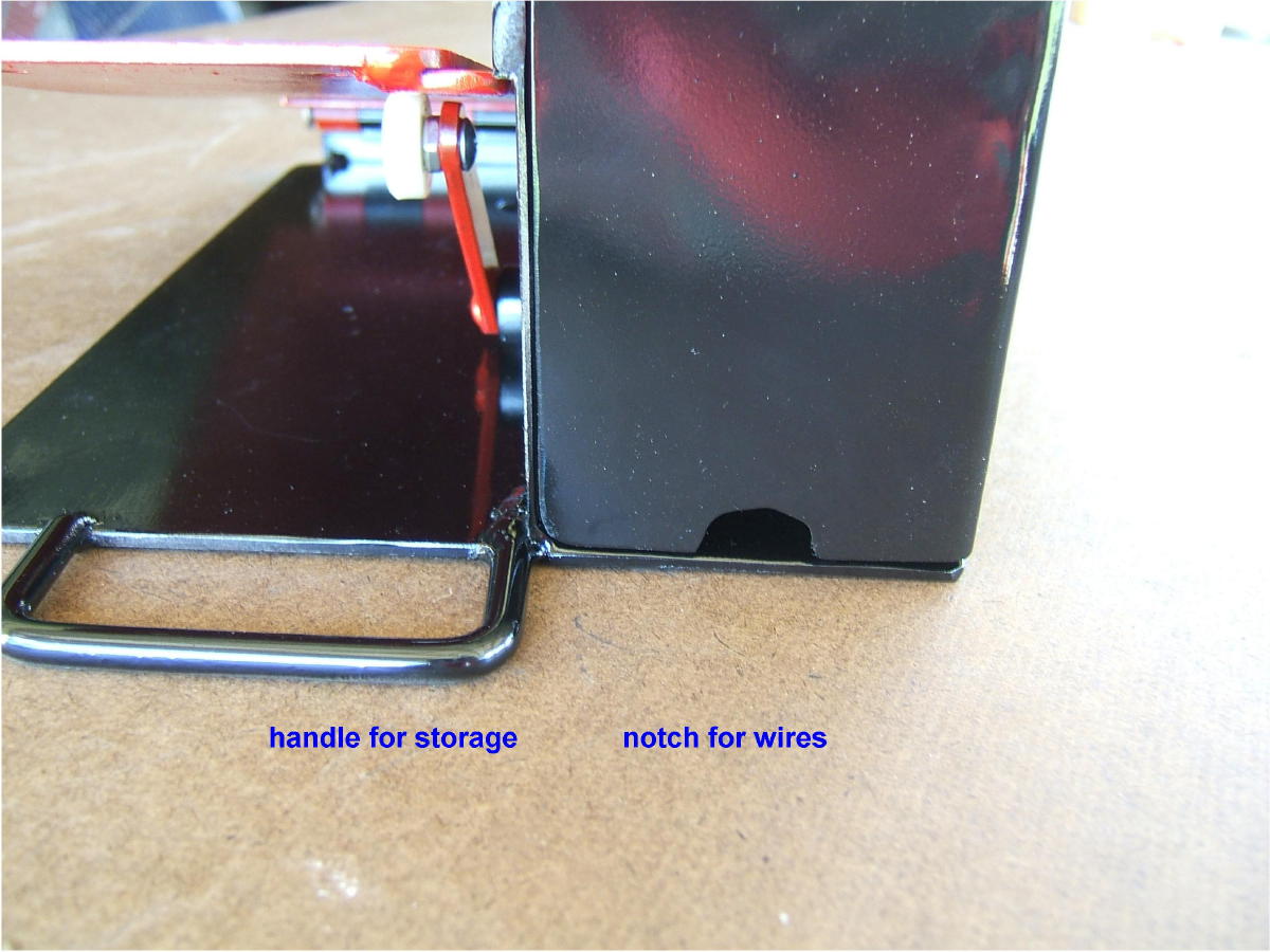

    I would guess the foot pedal on the left is just for storage next to the side where the welder is. When I built my foot pedal I put 2 handles on it one for hanging when stored andthe other a moving handle grip.
Name:	finished pedal (2).JPG
