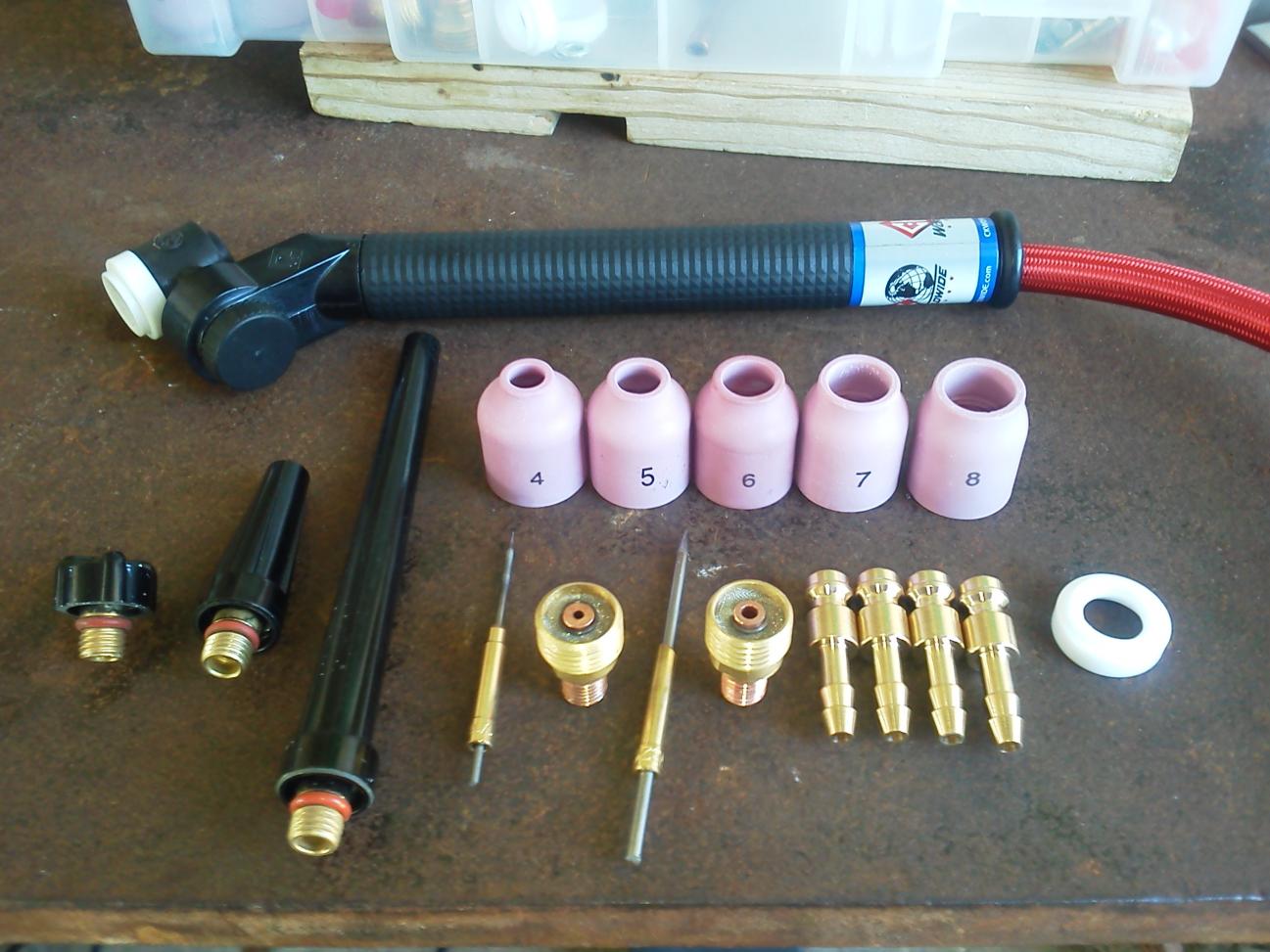

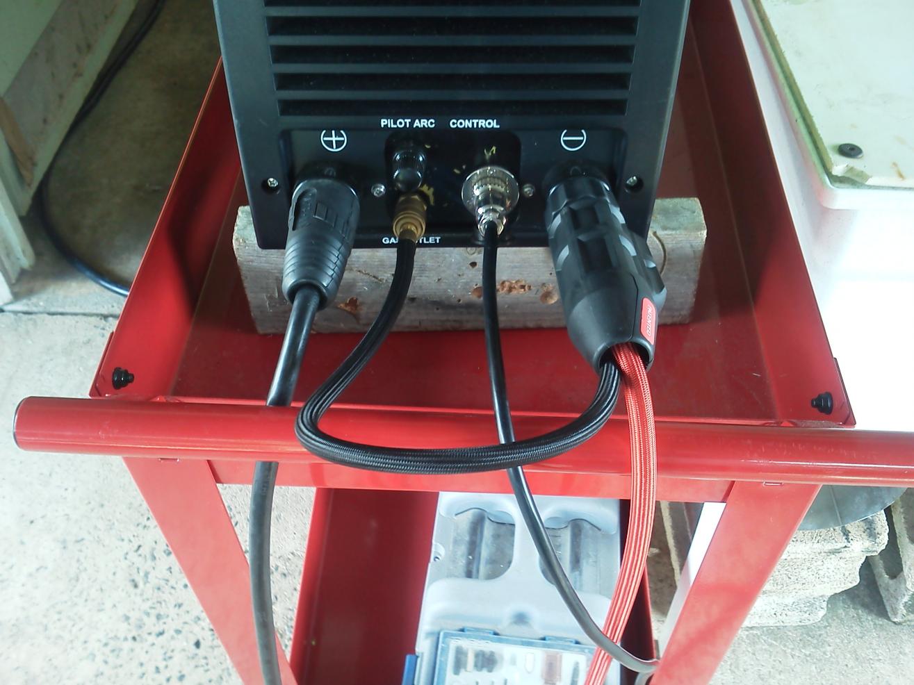

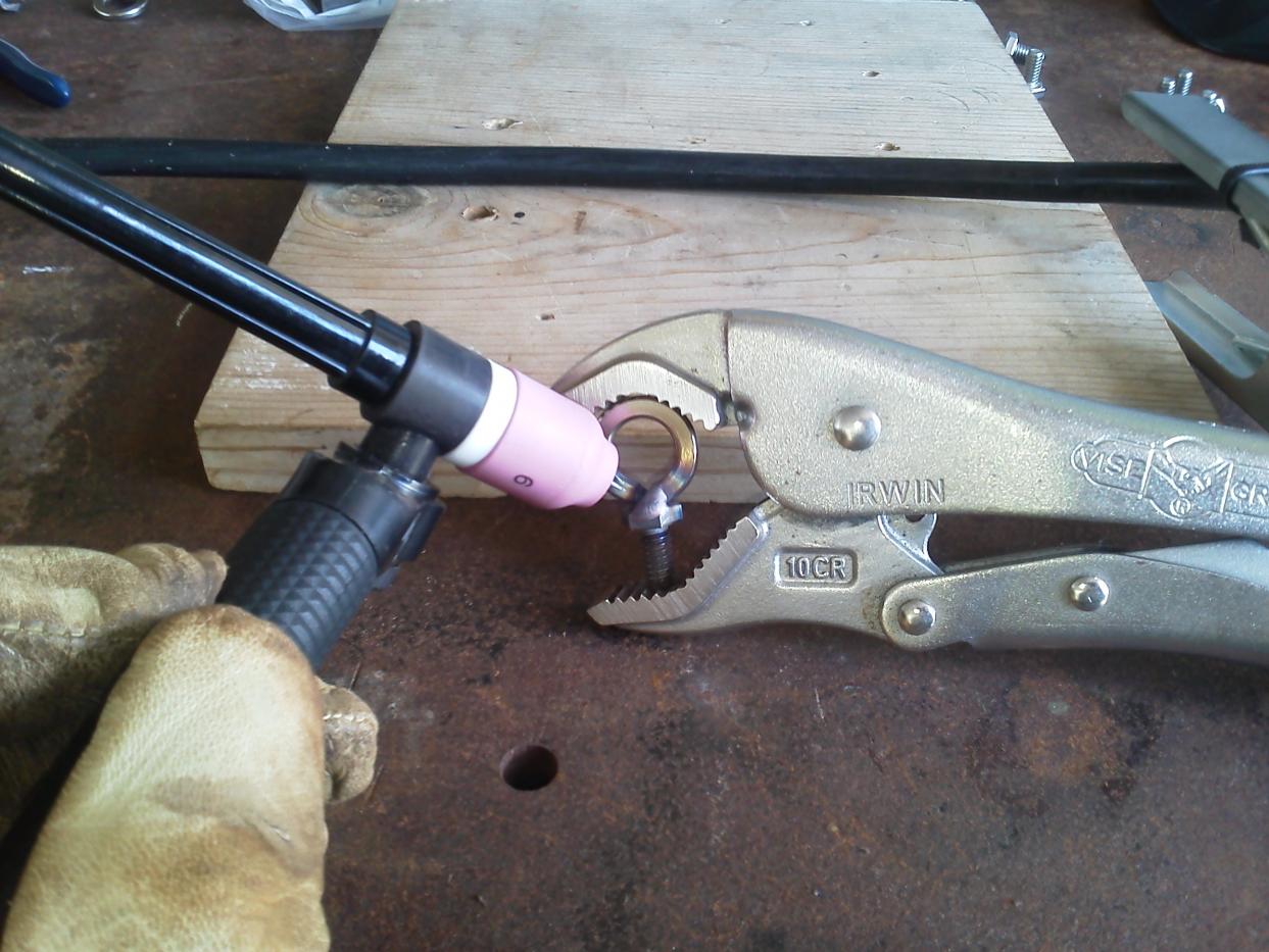

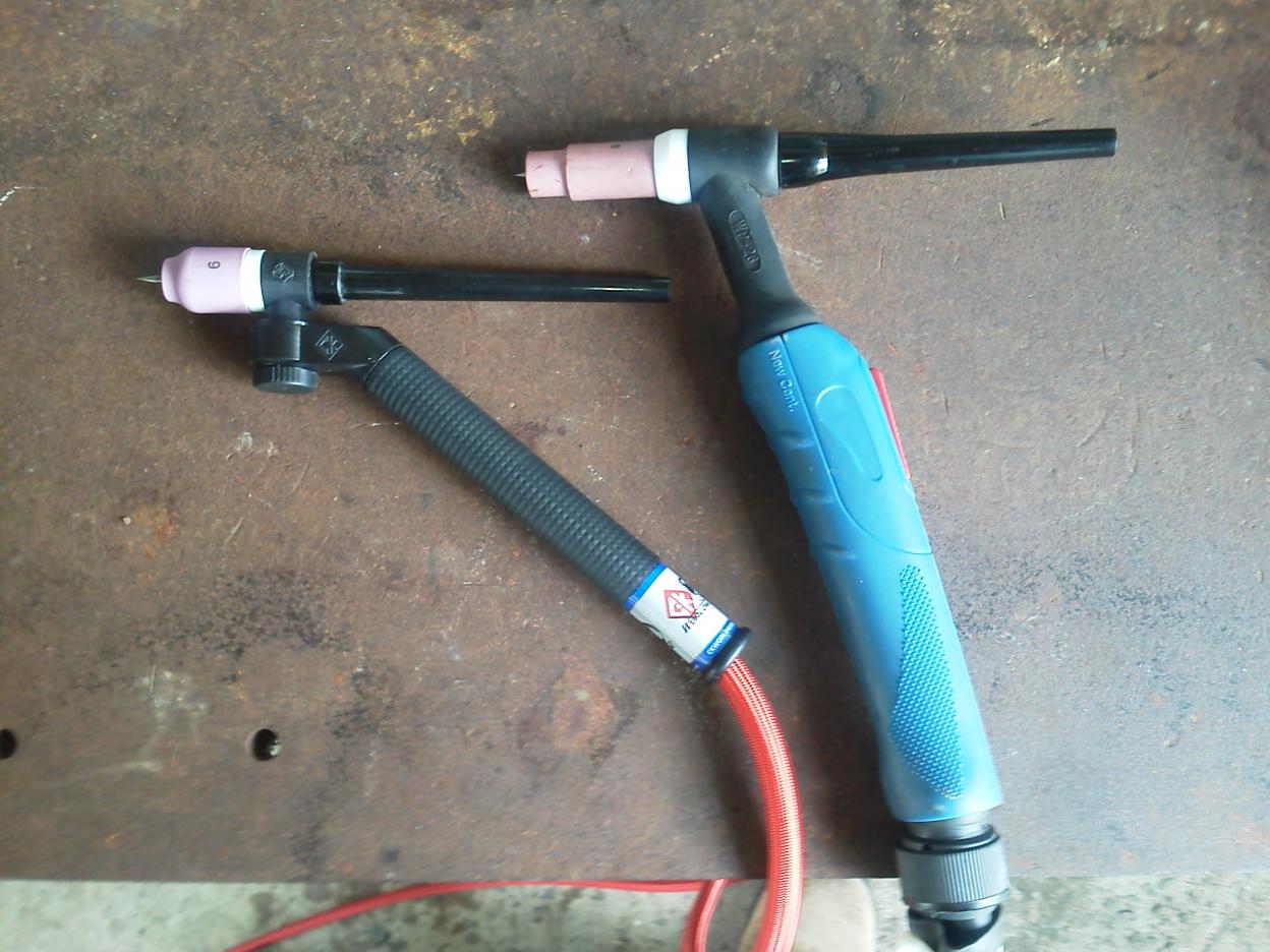

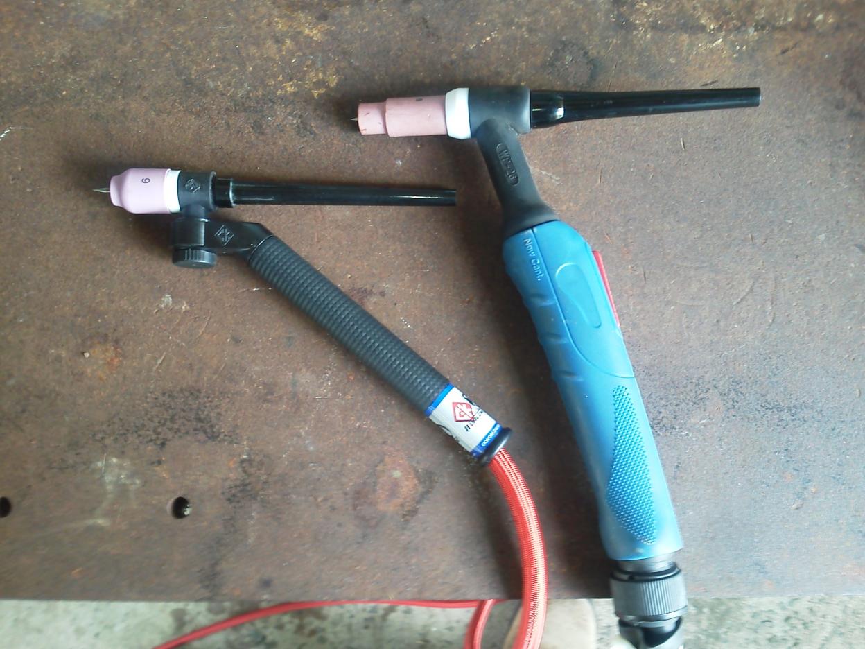

    Finally got my CK FlexLoc 130 and parts (Bday present) last week Wednesday and had a chance to use them on Saturday. My project was small, weld some SS 5/8” lock washers to SS ¼”-20 bolts, and I did rotate the torch head which made it much more comfortable. The difference in the FL torch and supplied torch is night and day i.e. weight and flex in the cable(s). I used the supplied torch for a year and now wish I had switched over sooner. Besides the weight and flex the ability to move the head is great. I originally thought that the FL torch geometry would be hard to get used to but it wasn’t.

    Listed below are the vendors and part numbers for my setup
    Weldfabulous
    CK FL1325SF FlexLoc Pkg 130A Fx w/. 25' 1 Piece SuperFlex 1x$149.95
    CK SL2-35 SafeLoc Male Dinse 35 (1/2") 1x$37.15
    CK 2C116GS Collet Wedge for 1/16" 1.6 mm 2 Series Gas Saver 1x$1.37
    CK 2C332GS Collet Wedge for 3/32" 2.4 mm 2 Series Gas Saver 1x$1.37
    CK 2GHS Heatshield Gas Lens 2 Series MS1209 1x$1.50
    Welding City
    Gas Lens 1/16 45V43 1x$1.79
    Gas Lens 3/32 45V44 1x$1.79
    Alumina Gas Lens #4 53N58 1x$2.70 (5 cups)
    Alumina Gas Lens #5 53N59 1x$2.70 (5 cups)
    Alumina Gas Lens #6 53N60 1x$2.70 (5 cups)
    Alumina Gas Lens #7 53N61 1x$2.70 (5 cups)
    Alumina Gas Lens #8 53N61S 1x$2.70 (5 cups)
    Back cap Long 41V24 1x$2.38 (2 caps)
    Back cap Medium 41V35 1x$3.58 (2 caps)
    Back cap Short 41V33 1x$2.38 (2 caps)

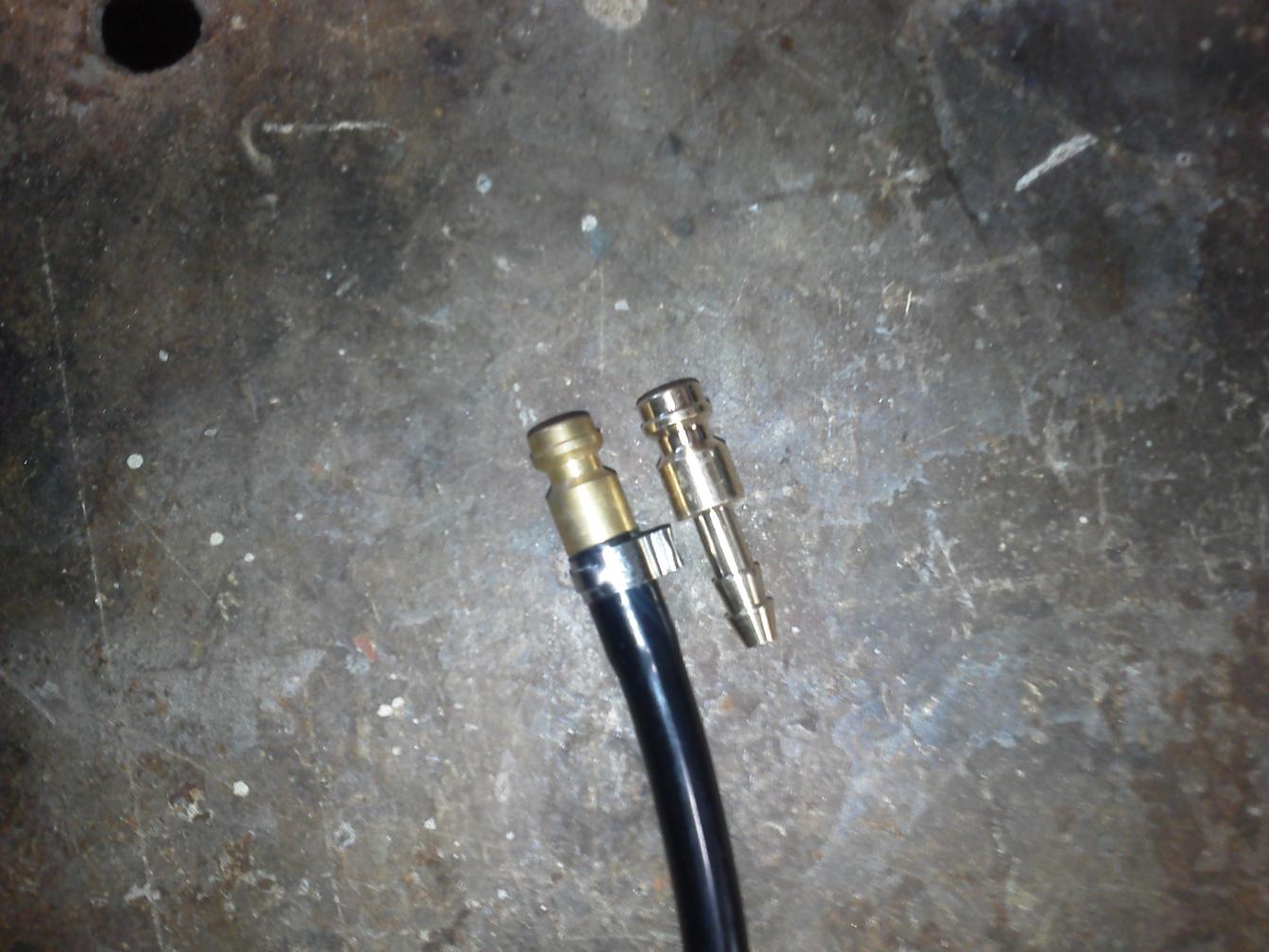

    LWS (Air Liquide)
    CK #1006 Ferrule 1x$1.88
    CK #2564 Male plug 1x$6.69
    Like Zoama said in another post if you add –LG to the SafeLoc part number (CK SL2-35-LG) you will get the Everlast QC fitting that fits most new machines.

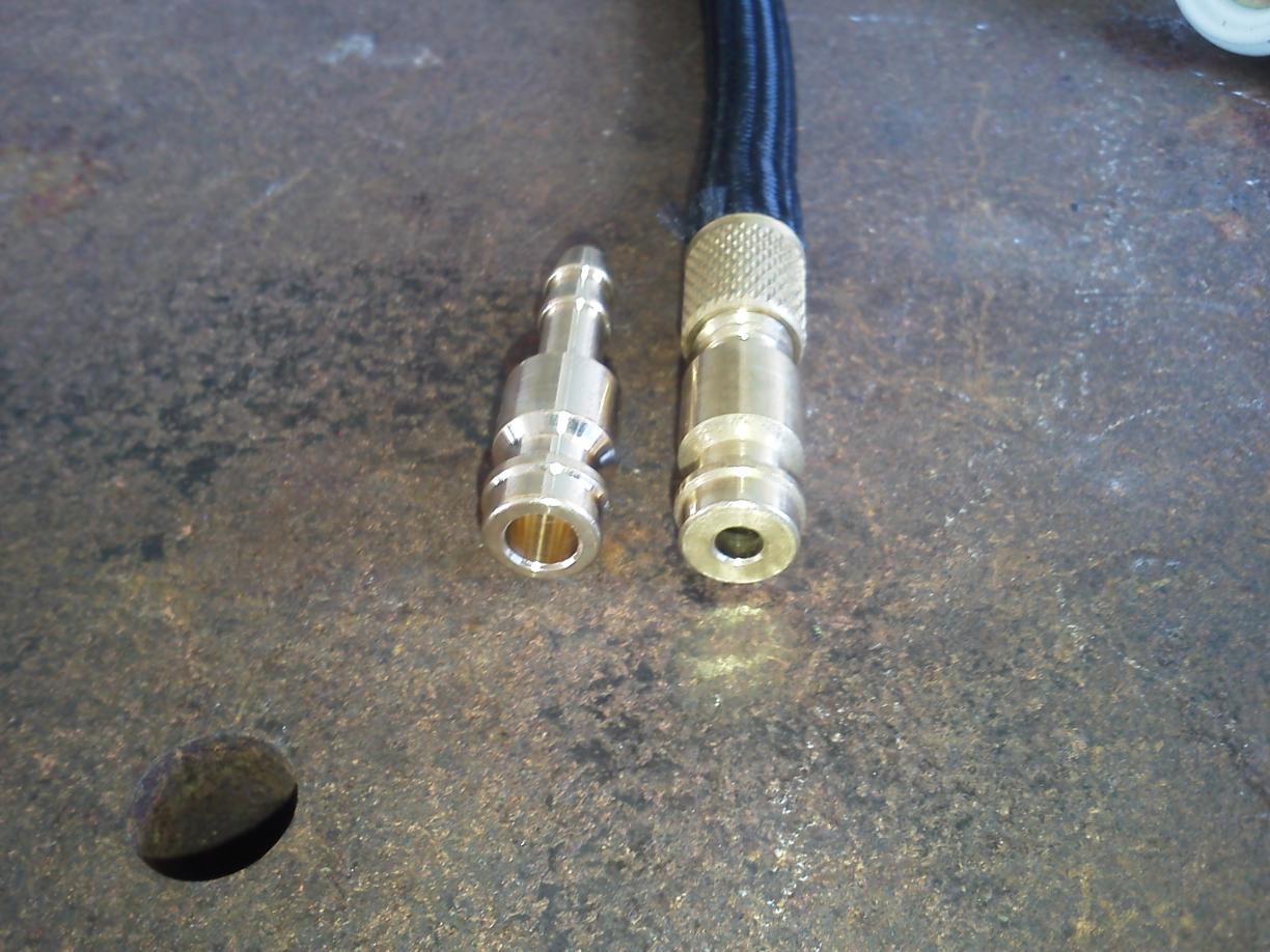

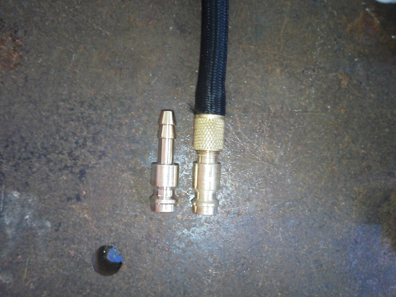

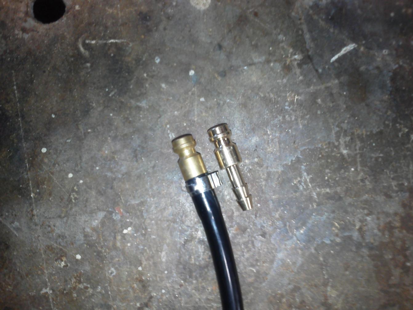

    Maryland Metrics(Male quick connect fitting)
    Rectus 21KA Hose Barb (brass) p/n 21SFTF05MXX 1x$1.25
    I ordered 10 to meet the minimum order ($10 minimum order) requirement, so if anyone needs one pm me and we can work something out.
    Pic 1 Below - Original male QC
    Pic 2 & 3 Maryland Metrics male QC and CK ferrule and male QC

    All of the above vendors ship USPS which is a huge benefit for me since shipping to Hawaii using UPS/FedEx is ridiculous.

    What you will find is you tighten the head by turning the head. You simply turn the head to loosen, re-position the knob in the direction that allows the head to tighten in the position you want, and tighten by turning the head.. I had the same feeling when mine was new, but soon learned.

    LOG learned that trick fairly quick, makes repositioning the head quick and easy.

    That really does look like a night and day difference (sorry Everlast-no slam here just saying what I see).....
    Thanks for posting the pictures. I really want to get the Flex Loc eventually when I get my 210 EXT. Looks like a very nice upgrade. Also appreciate all the part numbers!
