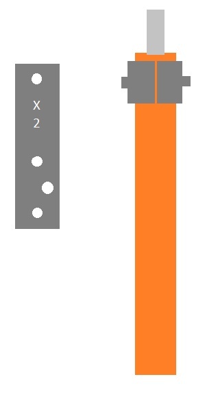

    Ok as many of you know I recently bought a JD2 tubing bender. I bought the manual bender because it was way cheaper but I had the intention on converting it down the road to air over hydraulic. Well the road was really damn short because I decided to do it right away lol. I know Swag Off Road sells a mount for the Harbor Freight ram but it has a major flaw in the design do to it's pivot point. The mount creates side load on the ram and will blow out the seal and from what I read can make retracting the mount pretty hard. Now due to the size of the HF ram creating a center pivot point takes quite a bit more effort but it should be done if you want to use this type of ram on your tubing bender.
    Here is what I'm working on and the progress so far. My mount will use the factory mounts on the ram rather than clamping down on the tube like the Swag mount does.

    I have an idea for a simple mount that would solve the problem. It's a new cylinder clamp with a pin on each side and two plates that would bolt to the last three holes on your bender with the cylinder mount between.
    The plates could be stepped if need be. Click image for larger version.

    Yeah the center mount like that would work. Using the last hole in the arm will take some work because this ram is so large and the factory bolts are in the way. Maybe building an extension mount like I did on the other arm would solve that. It just needs to be really strong. I'm not sure how much I like the mounts that clamp to the tube. Maybe it's just me but I worry about unnecessary stress on the tubing given that there are critical moving parts inside. But it should work out great.

    That looks like the hot tip. Compact, but center loaded.

    There are now clearance issues at all. Plenty of room all the way around. When the ram is fully extended it will only extend a little past the first adjustment pin hole. Basically this will only do a 45 degree bend without having to repin and start over. But that's fine and not uncommon. I could be wrong but I don't think the JD2 hydraulic setup will do a full 90 degree bend without repinning ether.
    As far as how the ram is mounted. Everything I have ever read about using this ram for this type of bender said this is the way it should be. As far as I've seen everyone using this ram successfully has it mounted in this position. If it's not working properly there is something wrong with the ram. I'm not expert on how the internals work on the ram but it seems to make sense to me. Here is a pic of the Swag Offroad setup. Even with their mount style that would allow you to rotate the ram with the manual jack on the bottom they don't. They say make sure it's setup the way you see it in the picture. Seems to work just fine for me. But then again I haven't tried bending any tubing yet. I will next week and post an update for sure.

    Quote Originally Posted by sticks View Post
    I agree with your assessment of the weak point at the mount to the bender. That first bend and the mounting holes are where you are likely to see a problem.
    You could strengthen it by fish-plating (another 1/4") it from the front mounting holes to maybe 6 inches past the boxed in area.
    Yeah I may end out boxing that in. I want to try a bend first. Once I do I'll be carefully measuring the mount in those stress areas to see if there is any stretching or distorting of the metal while under load. I could easily just go ahead and box it in and not worry about it but to save metal and to also educate myself on how strong this really needs to be I'm going to wait. I'm not sure if I will build this for others or not but if I do I need to insure that I'm not using too much material if it doesn't need it. That will increase my cost and the cost of shipping. People will only pay so much for it so those factors are important to me right now while I figure out what I'm going to do. This is my R&D time lol. It's just public witch might be stupid of me but oh well lol.

    Quote Originally Posted by Rafael View Post
    I don't think you will have to box it in, just reinforce the top and bottom plate.
