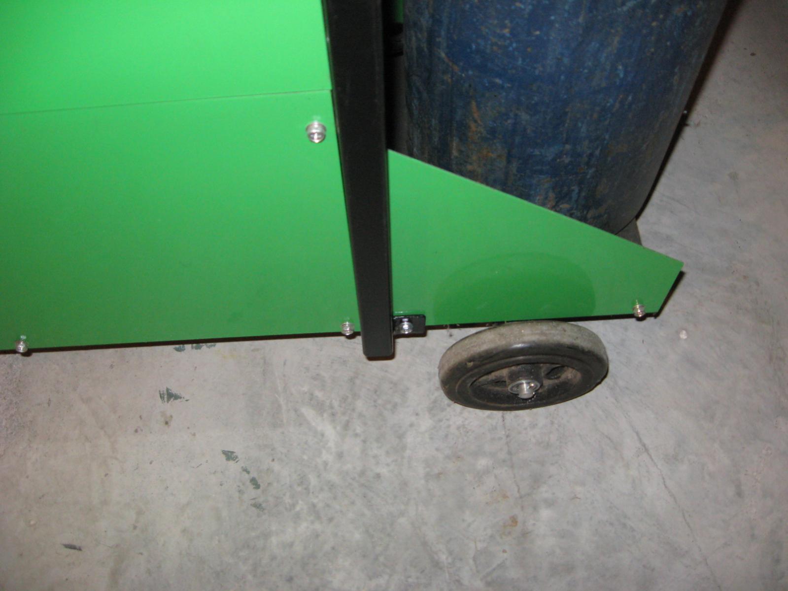

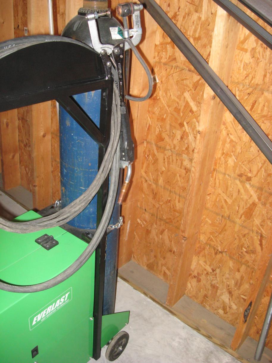

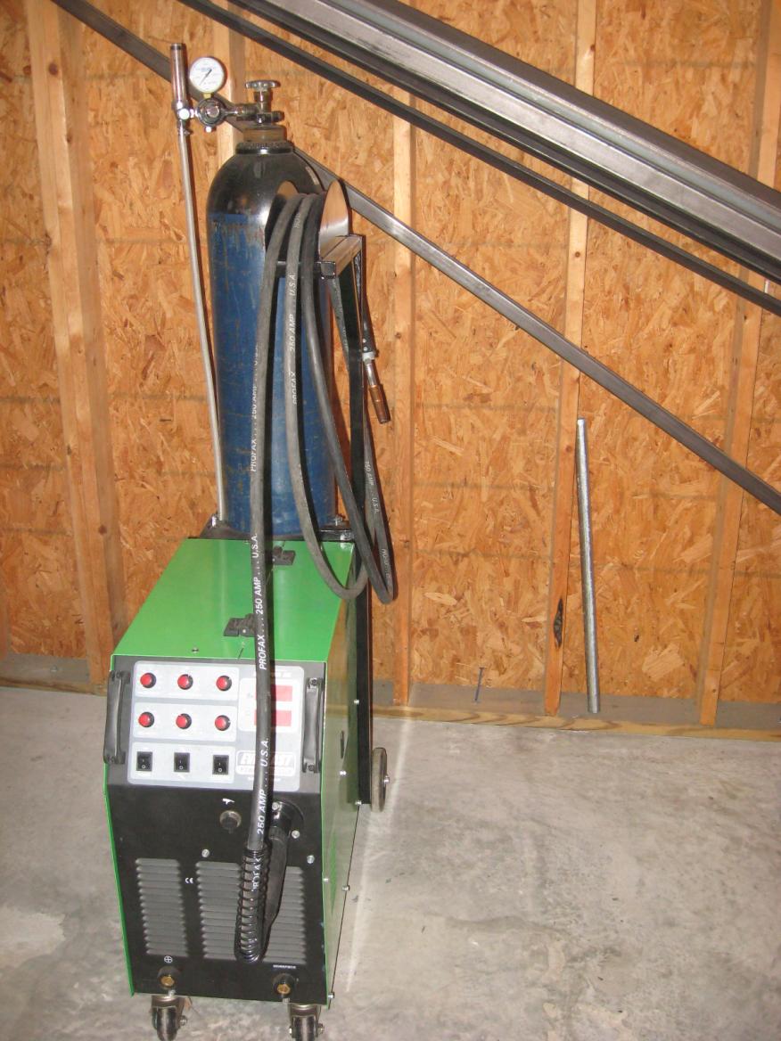

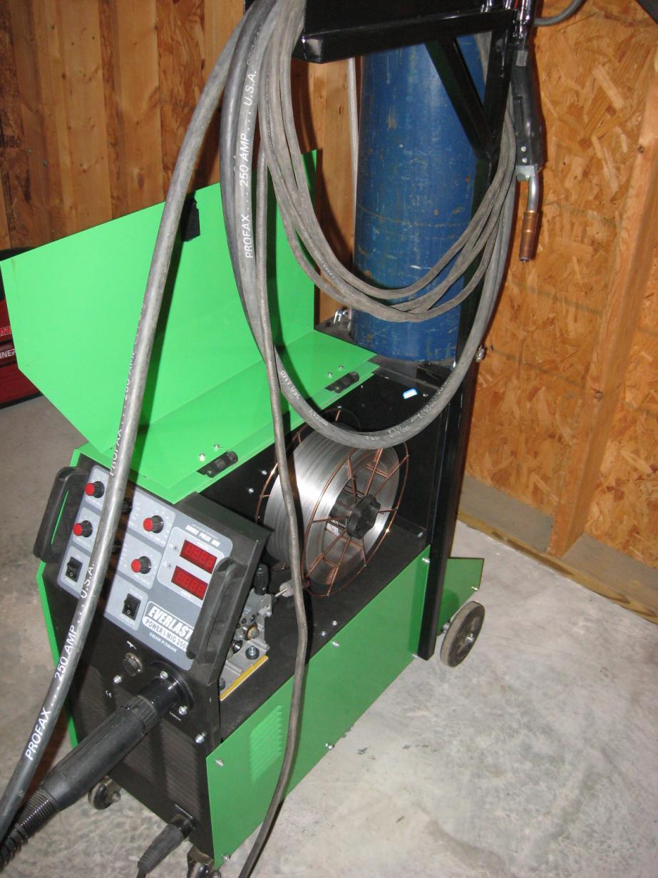

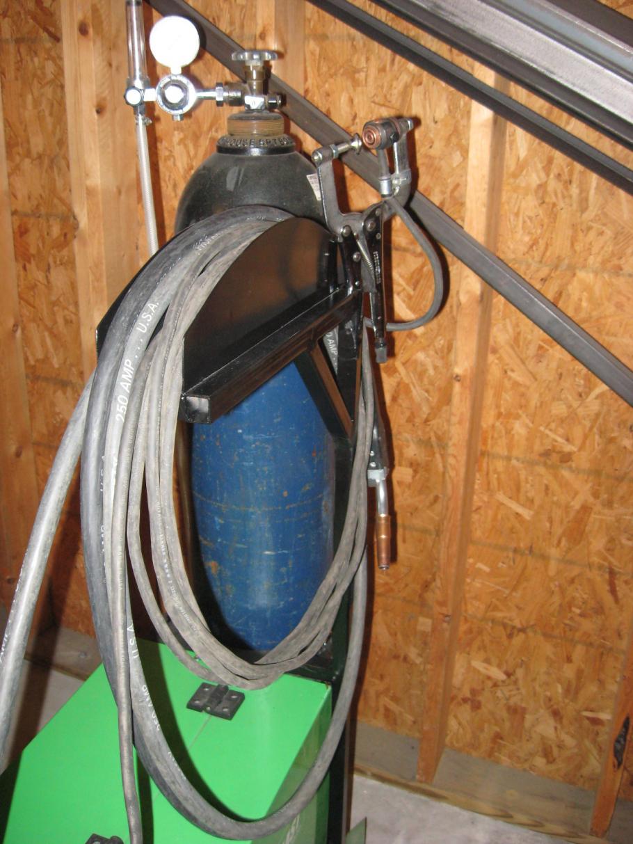

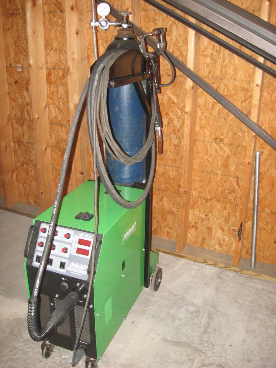

    Default I-MIG 250P Add On Lead Hanger

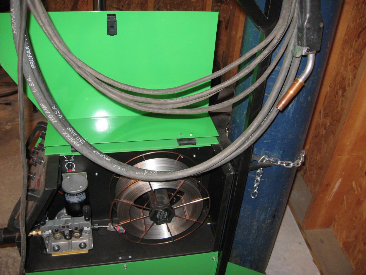

    Having adding a 20' Profax gun and 25' ground I needed a better place to store them rather than wrapping them around the bottle.
    I used 1" square tube for the frame and 14 gauge hot rolled sheet for the reel. I used an existing bolt to attach the bottom part of the mast and drilled one 5/16" hole in the bottle bracket to secure the upper mount.

    I like that. Maybe instead of trying to fit the beast into a cart like I was planning, I should instead build the cart onto the welder.
