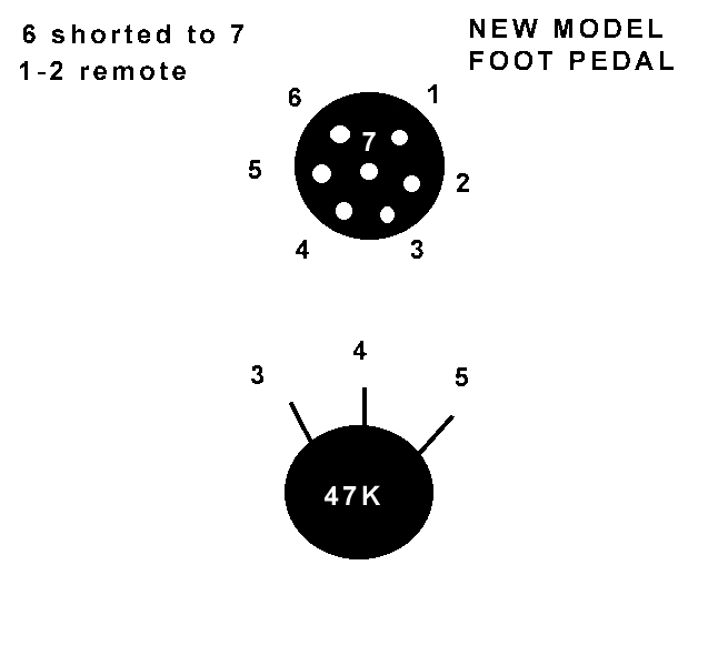

    We're receiving a lot of request for the front panel/foot pedal pinout. Here is the pin out for the new IGBT line. Always open the pedal and check it yourself, to make sure you have the same pedal.
    Pin 4 is the center of the potentiometer.

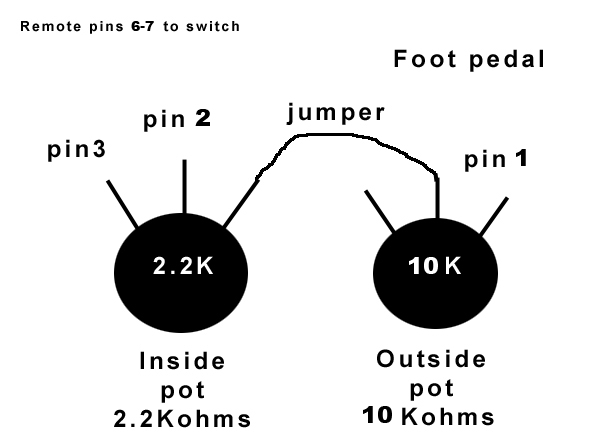

    Pedals with 2.2K and 10K, like CT and Super200P
