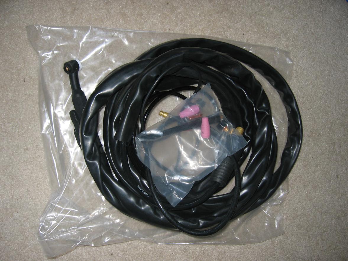

Holy crap is this torch huge! This is a CK9 flex head with superflex hose, I use this mostly. We have a CK150 for more amps.
