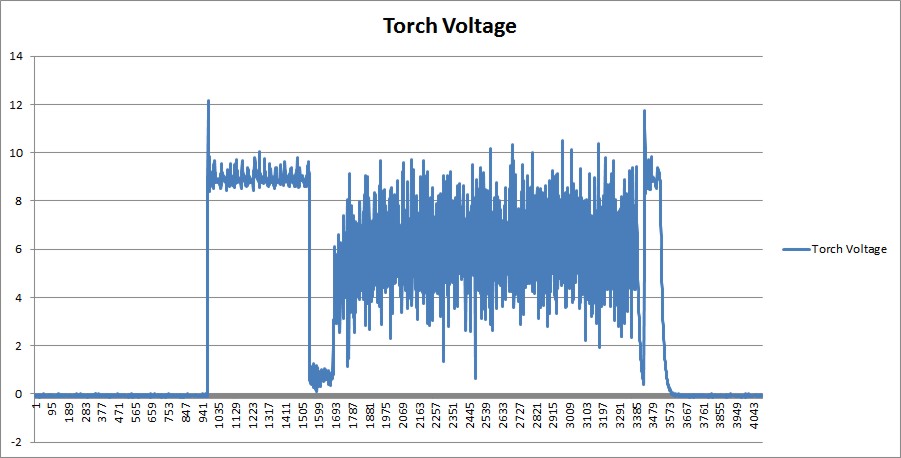

I also did a capture of the voltage on the CNC output port.  Here's what I got.
Attachment 7616
I captured the voltage on pins 4 and 6.  I didn't change the voltage divide jumper, but with a peak voltage of a little over 12 volts, it looks like the jumper is already in the 1/16 position. The X axis shows the sample number.  The samples are 20 ms. apart.
From the graph, I'm guessing that the intial full voltage is prior to the arc igniting.  I would guess that the voltage drops on ignition and then recovers as the torch stabilizes.  Does that seem to make sense?

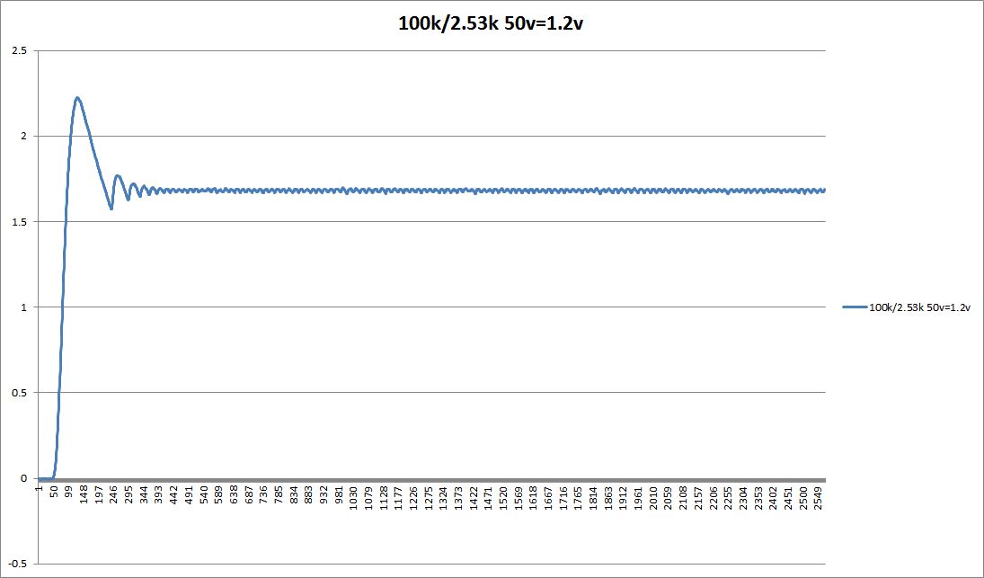

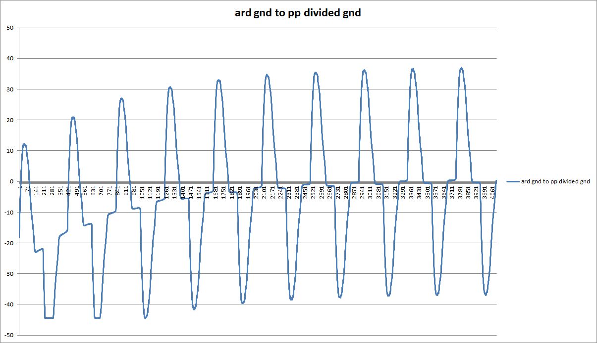

		I talked to my consulting electrical engineer.  He agreed that it's probably an isolated supply.  He thought that the a/c wave form I saw between grounds was probably just noise and so low a current it wouldn't be an issue.
I got the voltage divider set up.  The calculated values weren't giving me the expected voltages.  I believe that it's due to the existing resistors in the CNC interface.  So, I went with the "scientific empirical testing model".  I just kept trying different resistor combinations until I got the voltage I wanted :D
I also decided I'm going to add a couple zener diodes to protect the Arduino from overvoltage.
Once I get it all hooked up and know it works - I'll publish a schematic.
