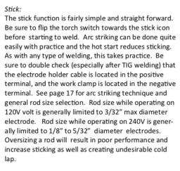

1 Attachment(s)
Gee,
Have you tried it with Stick on 220/240V first, just as a baseline.
Otherwise, I took a quick look at the PDF manual.
https://www.everlastgenerators.com/s...es%20200ST.pdf
See here:
Attachment 13977
Maybe a 20 amp 120V breaker is problematic with Stick though. I mean, I TIG with my 210EXT on a 120V/20amp breaker up to 125 amps with no tripping at all. But maybe I’ll try Stick on 120V sometime. I hear my 210EXT welds well on Stick, but after owning it for five years now, I've never gotten around to burning some good ole rods with it.
