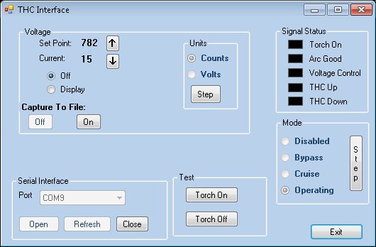

The Rev B hardware design (eagle files), Arduino THC code and Windows data capture code are now all uploaded. They are on "github"

Work will continue. I also have to work on the "users manual", software build instructions and the hardware build instructions.
If Rev B works as hoped, then I'll have a higher speed serial link and may try to add control from the Mach interface. Also thinking about moving to the Freescale Freedom platform, a 32 bit arm processor that's only $12 for a board.

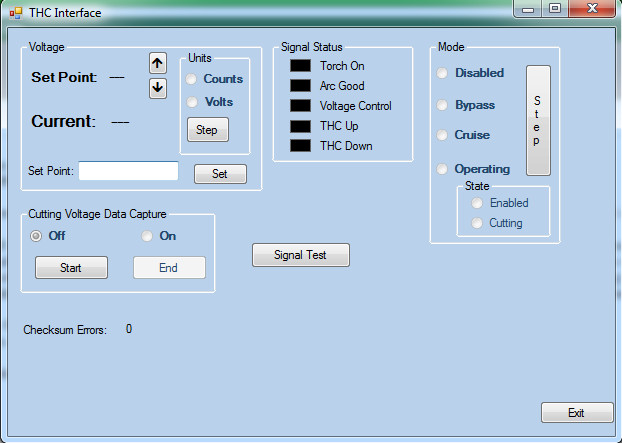

Since it seems pretty straight forward to do an integrated THC inteface in Mach - I'm going to go that route and abandon the LCD display. It shouldn't be a big deal to add it back later if I change my mind.
