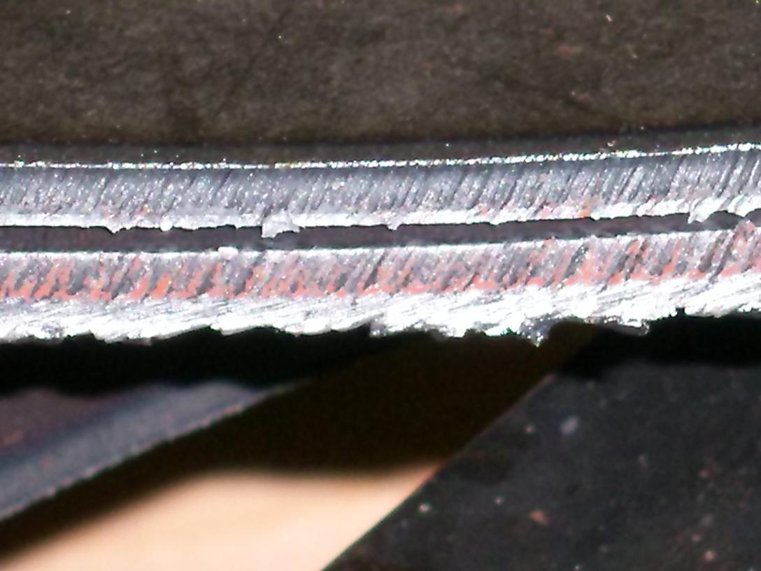

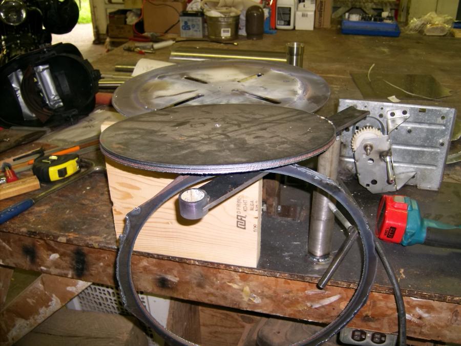

    I made a weld positioner for doing circular tig welds. By mounting a pivoting arm on the base, I find that it works really well for cutting circles with the plasma cutter. Cost of the postioner was zero, all from junk under the bench. Power for the positioner is a small variable speed Makita cordless drill.
    Here I have cut a couple of 18" discs (both at once with the little Power Ultra 205 multi)for a custom drum I have to build. The drum will go into a new machine being built for a large bakery somewhere in Salt Lake City.
    Here is a link to a video clip of the cut http://www.youtube.com/watch?v=iI0qbNjLCHs
    Looks like 28 amps is the setting showing there, not bad for cutting 2 at once (3/16" ea.) which is much tougher than a single thickness of 3/8".

    I captured the pics so I could reference them later, what we need is a picture of the gearing you used.
    I think I'm seeing a power window track there for the gear down. if that's not what you used, a power window mechanism/motor and a rubber drive wheel should work just fine.

    I'll take some pictures of the unit tomorrow and post them. I used an old gear reducer and a small part of the remains of a burned out electric garage door opener.

    Here is a link to another video clip that shows the postioner a bit better. http://www.youtube.com/watch?v=av-aIMH-iFQ
    The flat vertically mounted silver plate is the bottom out of an old garage door opener. I used it for the spindle since the other end of the spindle already had a sprocket of the correct pitch on it. The nylon gear is just along for the ride.
    The cordless drill just gets chucked onto the spindle and then activated by pushing the handle down so that it engages the bolt(ground the head roundish) you see me turn a little bit to change speed. Turning the bolt in and out varies the speed by pushing/releasing the trigger. The gear reducer is a right angle 40 to one unit. The sprockets give another 4 to one, so 160 to one is the total reduction after the drill.

    How do you attach the ground?

    I just clamp to the table and let it go around with the object being cut or welded. Sometimes I have to stop at about 3/4 the way around and reposition the clamp, not a big deal for the way I use the rig.
    Expensive weld positioners use weld brushes on the pivot shaft for the ground, probably a good idea if you are using a weld positioner day in and day out.

    why don't you use one of these and ground the shaft?
    attach it to a bolt on one end and put a spring on the other so it holds tension against the shaft, then just hook your plasma/tig ground to the bolted down end?
    I can't remember where I have seen this, but I have used it a couple times when welding broken shafts back together in a lathe, works great

    Brilliant! I have a 90 degree gearbox that I've wanted to set up as a positioner for tubing-type work. I gave up un the project a while back becuasa I didn't have a cheap easy way to drive the thing. It just so happends nthat I have a coulpe of cordless drills with dead batterys laying around. I will be starting a thread on powering them, up with regular AC. Thnaks!!

    I use the little weld positioner all of the time now. It gets used roughly 50/50 for welding and plasma. I built it with welding in mind, but the addition of the pivoting arm made it quite useful for cutting circles or part circles with the plasma cutter.
    Next I added an steady rest for the forearms to lay on when tig welding. This is just a 10" long block of 2x 10 placed on edge and fastened along the side of the metal base plate. The block sits about 1/2" from the turntable at the closest point.
    I just realized that you can see the block in the video, guess it was already on there when I filmed that.
    Anyway, in case anyone wondered, that is what that wooden block is for!
    ScratchStart, good idea, I 'll give that a try.
    Most of the time just clamping the ground to the turntable works fine, but once in awhile I'm doing something where it gets in the way.
