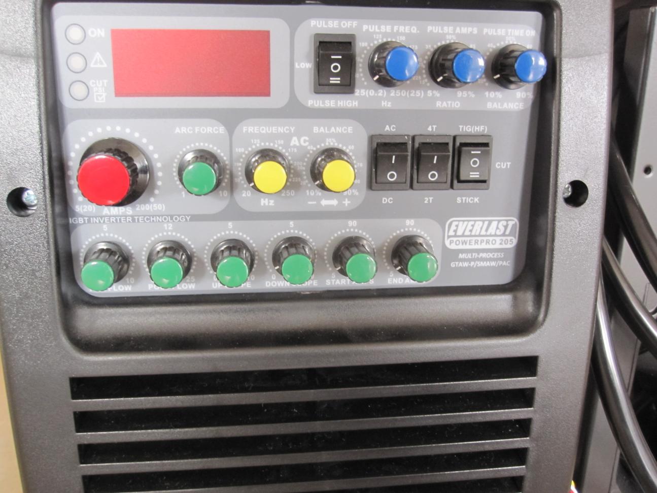

    Here is the Face for the 205 you can see the Parameters and functions have been improved. You can also see the added CNC outlet at the rear of the unit.

    so from the pics, i notice the changes to:
    pluse freq. (more range) and amp setting (% VS amps)
    up and down slope time now 0-10 vs 0-5
    added pre flow 0-10
    added start and end amps
    added more numerical refrence points
    CNC outlet on rear panel
    added cut/psi led?
    all great stuff man!!

    We have been holding it close to ourselves about the improvements. I guess now the calender stopwatch starts for our competition to catch up. lol We have been working with the factory on ensuring adjustments are more linear. While they are not be 100% perfect in all cases, the numbers will be fairly close, if nothing else, they will be a good reference point for repeatability in settings. There are more tick marks to allow finer tuning as well, that should in most cases represent fairly close whole number values, by 2's, 5's 10's etc...though not in all cases. The round dots should be a little easier on the eyes when setting as well. The older ones weren't very favorable to either repeatability, or readability.
    Don't forget, there is NOW an off switch for the pulse. Its not that the pulse couldn't be neutralized before, but its that it took messing with the pulse amps knob to get the pulse to shut down. Now, you just leave things where they were, and shut it off. The feature you did bring out, is that the pulse is operated by percent, not actual amps. In this style of pulse, it will agree with foot pedal operation more, though I still recommend pulse for the torch switch....But if people like to watch dogs chasing their tails, they will like the way the pulse operates much better with the foot pedal. lol.
    There is a dual range pulse just like some other units as well, though the higher range is lower, it is definitely a much better pulse range...though I believe most people will still be using it mainly in the .5 or so range for timing their dips.
    The cut psi led is added. It indicates when cut psi is OK....not when it is deficient. We will still have the regulators in the back. I have had a call or two on this to ask us about it because they have noticed some other companies are adding it to their front, which really does not make sense on a multi process, especially when using a single front connector for the torch. Running argon through a second regulator geared toward pressure regulation, creates problems in setting and proper regulation. The more direct the path of flow of argon to the torch, the better.
    Oh, and if anyone cares, a new Everlast logo we brought out in November on the panel fronts.

    Looks like a lot of nice features now on this unit. Would it be fair to say that the only major difference now between this and the PP256 is the amperage? As a hobbyist, I don't think that I need all the power of the 256.

    There are frequency differences...not as much and they won't have the low AC amp start, with about 20 amps being the minimum. There are differences, still. We aren't wanting to kill off the 256's sales. Each unit will have its place.
    For us newbies, could you explain how this would affect the practical use of the 205 vs the 256? Also, what, if any, differences is there in welding capability between the muti-purpose PowerPro units and the weld only PowerTigs?

    For newbies, it is hard to get into detail. Its basically going to depend upon your needs. The changes made to the unit do not affect function of the unit one bit with general foot pedal use except for the way the pulse functions. The only place you will see any difference is in the torch switch operation. The pulse only gains maximum efficiency and practicality with the torch switch as well.
    Yes, I believe, that the dedicated powertigs are better units with all things considered. Less to go wrong...no shared components. The 250EX has the 5 amp start on both AC and DC. Its not that the multi process units are awful or bad or anything, its just that from a purely mathematical standpoint, they will have more problems. They are heavier from the additional components needed, and overall, less room for components, hence, less tolerance for abuse. Changing out torches frequently also lead to disadvantages in production. When/IF a component goes out, you not only loose that component while you send it out to have it repaired, you loose them all. Having separate units is better for most people...
    Many "newbs" see it as a chance to shave off a little money...which attracts many customers. However, these units were meant initially for other markets. They were intended for portable repair and factory repair situations, and never for fabrication use. The rub comes with the customers when they realize the limitations. I have never had a customer call me back up and say they wished they had bought an all in one instead of a separate unit. Yet I have had customers call me up and tell me they wished they had bought a separate unit, instead of a all in one. Yes, we are adding CNC, and we will see how it goes, but they should not be bought for dedicated use as a CNC cutter either.
    OK, now that I have brought the units down a little, let me build them up, hopefully outlining their appeal and function.
    1) Yes, they are decent units with exceptional value.
    2) Compact and portable. If a customer needs to travel around a bit, A single unit, is better than two.
    3) They weld smooth as any of the competitor's dedicated units.
    4) Plasma cutting capacity is very good, though I feel it may be slightly less than the dedicated units.
    Even though they weren't intended for the hobbyist market, they will make a hobbyist a decent unit as long as they understand the advantages and disadvantages alike and still feel that it will fit into their needs. However, if a customer is expecting to "expand" their hobby, the customer will generally want to buy two dedicated use units after that. The money they saved initially comes back to cost them more in the end.
