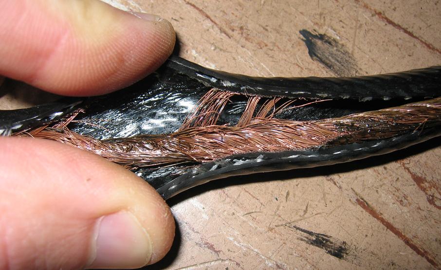

    My 1 year old Miller Bobcat 3 Phase states it will do TIG. I would of course like an Everlast dedicated TIG but funds won't allow that presently. The Miller catalog is somewhat confusing to me as to what I need to do simple TIG welding (Mainly Stainless Steel) with my Bobcat . Can someone tell me what parts I need to add to accomplish this as cheaply as possible (I need to save for an Everlast). I certainly don't mind non-miller parts because Miller is mighty HIGH.

    That's basically a WP-17, with flex neck (a nice feature IMO) and a valve. That one says it has a two-piece power cable, which may be a larger (and more cumbersome) cable than a one-piece setup, but could hook up to your machine without any adapter required at your machine end. A one-piece cable can be designed with a smaller size conductor, because the shielding gas flows past, and helps cool the conductor. You may want to see it physically and hold it and imagine what it would be like to weld with, before committing to buy it if possible.
    A WP-17 style torch usually allows for 150 amps DC at a 60% duty cycle. Be aware that this torch could limit your current and duty cycle (although not as severe as a WP-9 would), compared to what your machine is capable of (200+ amps @ very high duty cycle, right?). A WP-17 would be a good fit for welding smaller metals, but if you wanted to be able to weld thicker stuff, it might make sense to upgrade the torch to a higher capacity aircooled.
    If you exceed the duty cycle of your torch and cable, IME with a one-piece cable, the braided copper conductor inside the cable can melt the hose material, causing shielding gas contamination, and even possible melt completely through the wall of the cable. (see attached)
    The problem with the high capacity aircooleds (like a typical WP-26, rated 200 DC amps at 60% duty cycle) is that the handles are huge, and the cables are big and stiff, so they are quite cumbersome and unwieldy, not very pleasant to use.
