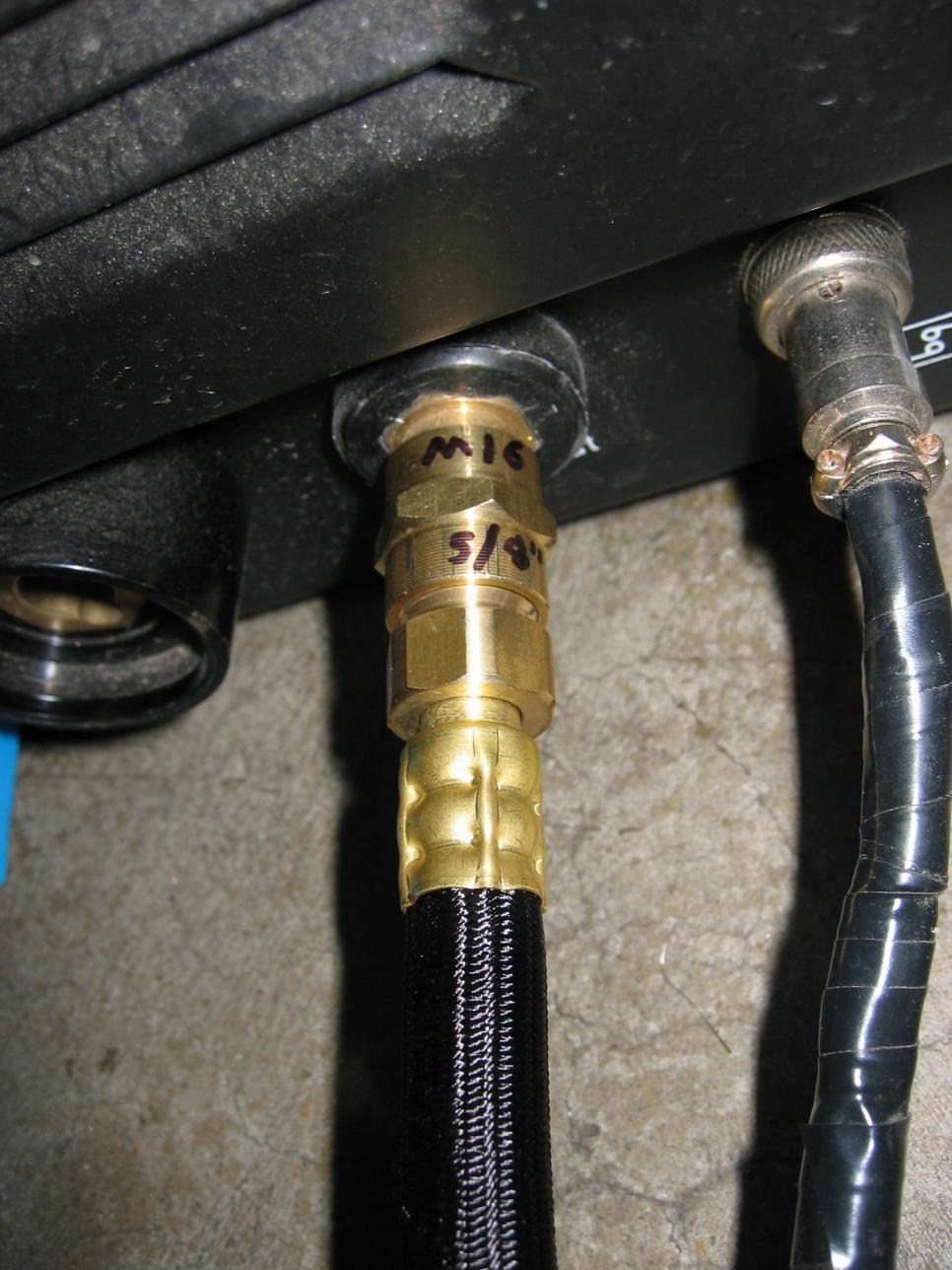

    My Super200P came with the PT-31 plasma cutter also. The threads on the power/gas fitting are M16 x 1.5mm. I've got a M16 x 1.5mm tap set that I used to make an adapter to hook up an aftermarket TIG torch to this machine.
ID:	1636   Click image for larger version.
