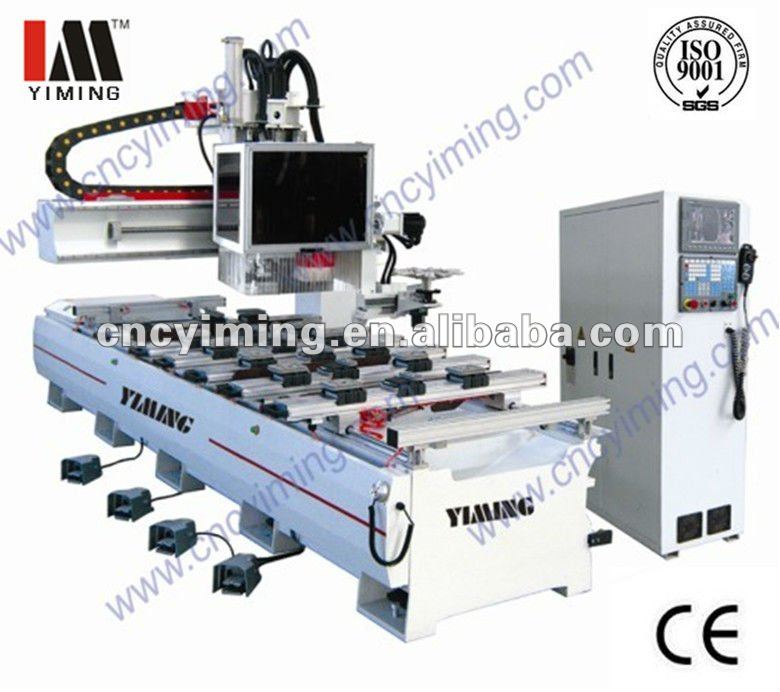

ID:	6733wow this is such a nice Plasma table like the way its drive motor are set up was thinking of a cnc table with gantry supported by just one side thing it would be easy to design. then would be completely open to load sheets of metal
  8. #68
    I would think it would be best to support the gantry on both sides, seems it might be hard to keep tight tolerances otherwise.

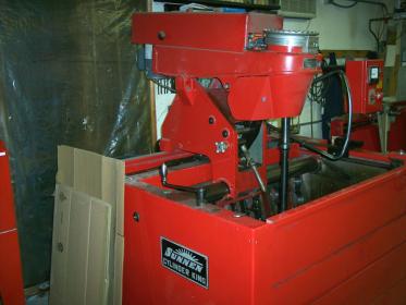

ID:	6877I have to machines for machining engine blocks the there over 20 years old and have no play in the single support system the over hang weight on my head resurface machine is like 600 to 800 pounds . think a set up like what a sunnen power stroke honing machine would be a good way to go since has no play and moves really easy
  10. #70
    A cantilevered arm would be fine for a plasma setup. After all there are no real loads to speak of. As long as it is rigid enough not to oscillate as it is being moved around. It sounds like a great way to save space. You could just roll up a table under it for cutting and use the table for other purposes when not cutting. Or make a table that breaks down for storage. I really like the idea.
    Those CK10's do last forever. Of course having honing oil on everything does help.
