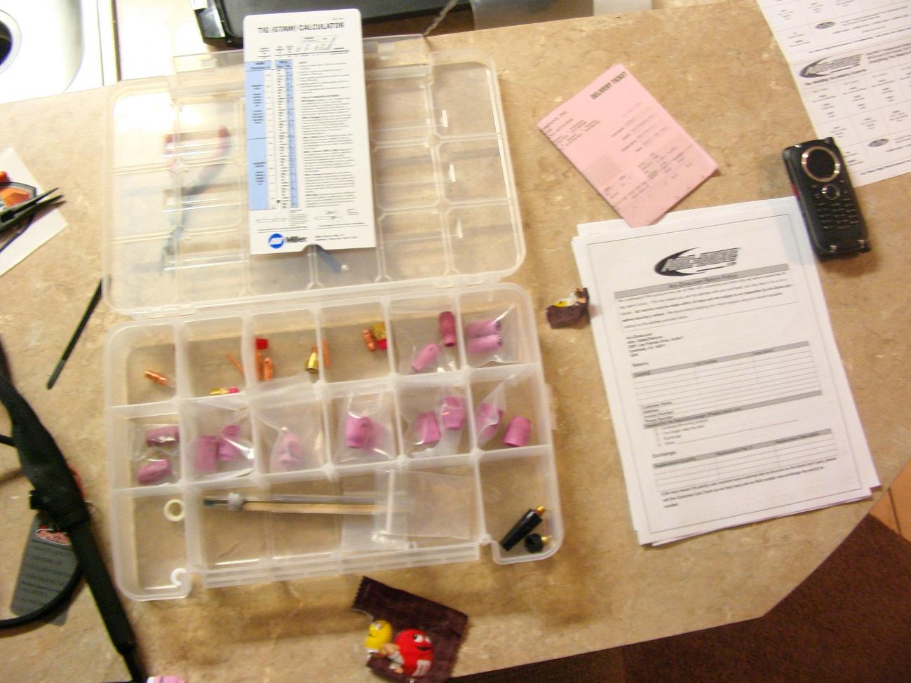

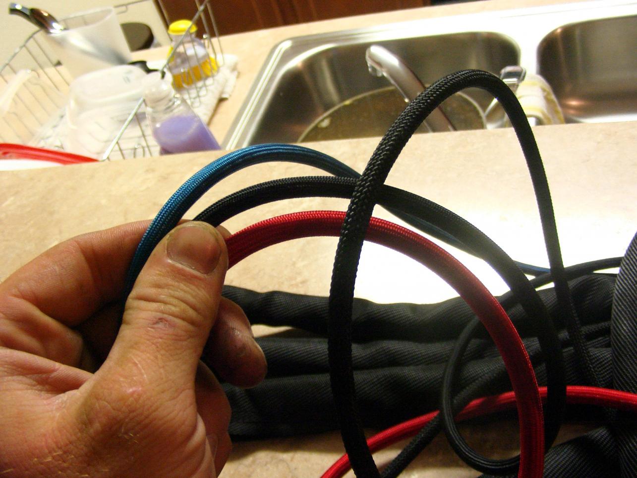

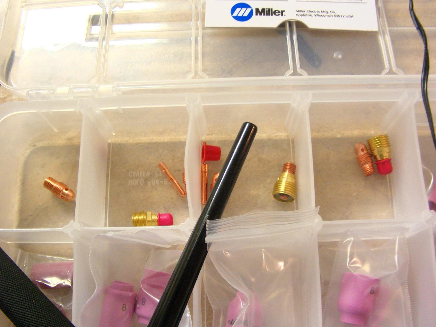

    I received the kit from arczone all in all im glad i bought it but when things start needing to be replaced i will hit ebay (welding city)
    here are some pics of the kit and also the weldcraft wp 20 that i pieced together off
    ebay and fyi the dinse connector was 38 with free shipping its a weldtec looks to be of decent quality and the cable cover is a profax from my lws everything it very flexible it was 38
