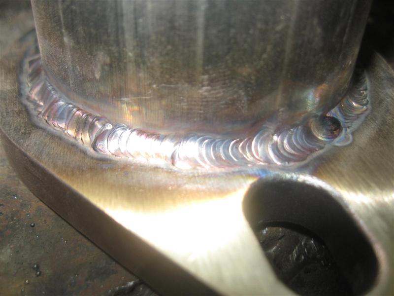

    Hey all, here are a few pics of an exhaust I'm working on for a friend of mine.
    3" 304 (.055 wall) stainless mandrel bends that he got from jegs.com
    3/8" stainless flanges
    6" stainless flexpipe
    Used mild steel exhaust cutout
    Welding it up with my powerpro 205
    2% thoriated 3/32 tungsten ground to a point
    ~65 amps to weld the pipe to the flange, and flex pipe, ~ 40-42 amps for butt welding the pipes
    308l 1/16" filler for everything except the cutout for which I'll use 309l.
    On to the pics!!!
    The flange welded up
    This is about 3/4 of it, ran out of argon, so I'll get a refill tomorrow, and weld on the cutout and another flange to finish it up.
    I'll post more pics when I finish it!
    Got a little crazy on the flex...lol still, not increibly bad for t total noob, it's my first real project

    There is more to the project than a couple of pretty beads, there is the fit up, making sure the bolt holes line up and the bends go the right direction, at least that's what I see in your first project, more than just welding. looks good.
    thanks again, geezer...its not my first exhaust build, i've done a few of these b-pipes before, but its my first that is tig welded. fit up is definetly alot more important with the tig i've noticed, its not as easy to fill the little gaps with weld like i used to do with the mig..lol
    anyway, like i posted last night, i welded a section of 2.5" 304 stainless pipe (.065 wall) to a 2.5" flange, to mate to the rear section of exhaust, and definetly noticed a big diffrence between that and the thinner .055 wall stuff that my buddy bought to build the b-pipe with.
    welded this part up with ~ 70-77 max amps, with the footpedal controlling the heat input, i was having a bit of a struggle getting it to melt into the flange with less amps.
    ill take some more pics tonight, should be able to finish the b-pipe up, then i will start working on some intercooler tubes for him!

    Nice work! Close ups of your lap and fillet welds show yoy are getting some really good fusion there, and not a whole lot of oxidation either (something many strive for, whether actually necessary or not.) That exhaust system is going to last the lifetime of the vehicle.
    What is your inert shielding setup? (cup size, gas lens or standard collet body, flow rate?) Any solar fluxing on the butt welds?
    Welding in a circle can be a PITA, next time try using lazy susan bearings (big ones) from Home depot (9 or 10 bucks) with a scrap plate laid on them, clamp your piece in a vise, lay that on the plate and then you can nudge the whole thing around with your elbow while maintaining position. Cheap rotary table.
