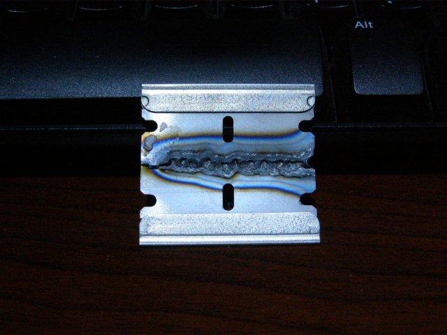

    Below is a pic of 2 razor blades I welded together a few moments ago.
    Ok your asking yourself why am I crowing about a bad looking tig weld on 2 razor blades.
    This weld was done with a 26 series torch, medium gas lens, #8 cup, .040 2% lanthinated tungsten, 7 scfh argon flow, scratch start, 1/2" thick copper backer bar.
    The kicker here is the power source was 2 spare 100 watt solar panels wired in a series.
    Approx 25VDC at 5.25A Torch wired straight polarity.
    I have wanted to try welding with solar panels ever since I put in my array and drew a nice arc one day while wiring them.
    I think the test was very successful given I have less than 36" total tig welding experience to date.
    Now to practice.

    I wonder what kind of efficiency you could get by powering the solar panel with the arc flash? You may have created a perpetual machine here. lol.

    There was not much arc flash. I could almost use dark shades for welding with it. My Harbor Freight cheapy helmet works great at 5A though.

    I saw that "low amp solar TIG" addition to your tag line and meant to ask you about it. Green welding, who'd'a thunk it. Next you'll be welding razor blades with a transformer from a neon sign!
    hmmm... I might have to try this out. you know this more thoroughly than I, but Texas has LOTS of sun. if I could get 20A, I'd be golden

    20A You need 3, 27V 8A 200 watt panels wired in parallel. See http://sunelec.com/index.php?main_pa...oducts_id=1657
