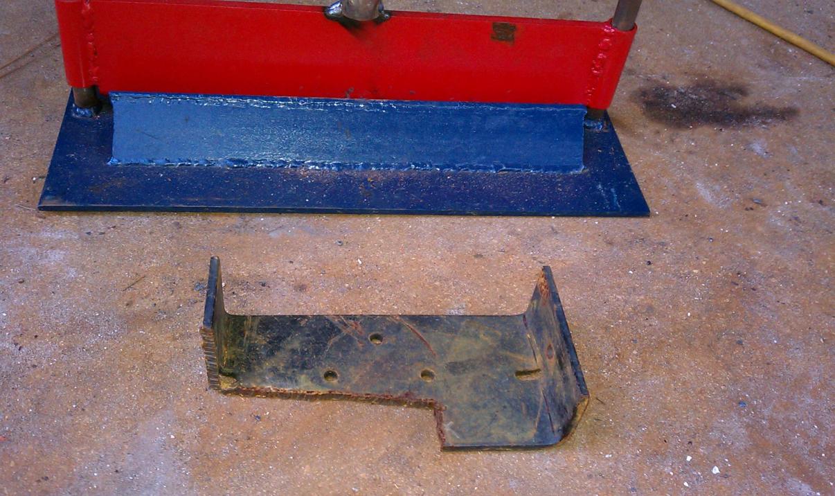

    This is a brake I made for my Dad who is helping me post. Some of the welds are not pretty I did not know the arc force applied in MIG on the IMIG-200. now I do. Did not fix them since penatration is good. Idea taken from Scooter here on the forum.
    16" bend max 19.5" base 2.5"x2.5"x1/4" die all scrap metal. Getting metal for the press today and a free 20 ton bottle jack from the guy. I am 15, never been to a welding school yet but helped my Dad for 2 years. I will post more projects soon.

    Thank you all for the good words. We finished the press this weekend and I will post pictures. No paint on it yet. Bent 1/4 no problem and 1/2 x 1 1/2" no problem.
    Here is a couple bends 1/4" for a bracket. Also made the handles for the press with the press and brake. I posted pictures of the press in another place here after handles and paint.

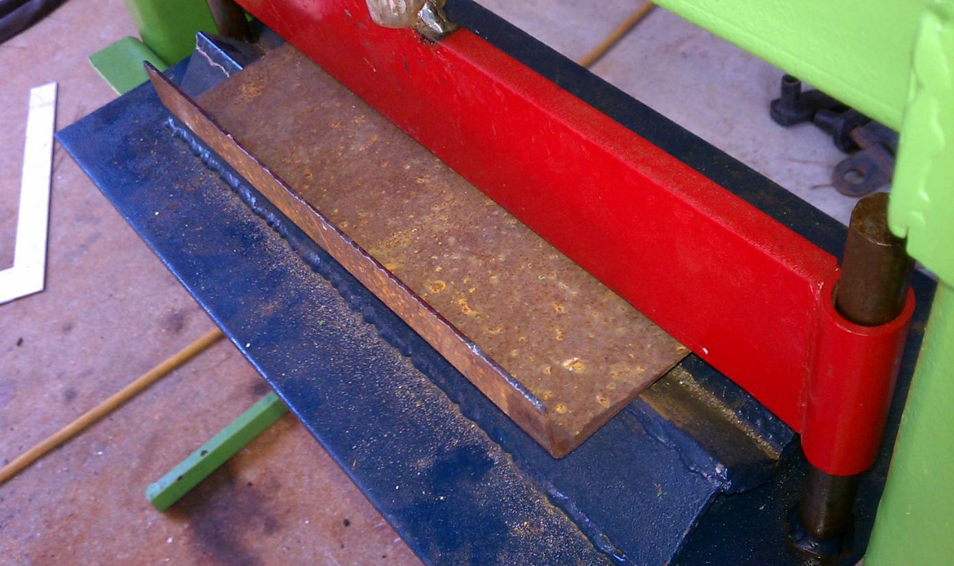

    If you had to guess what was your angle between where the metal is pressed

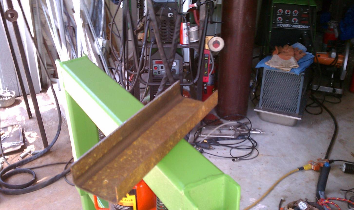

    i have to ask my dad. It is a copy of the one Scooter on the forum made but my Dad got all the metal and made the blade and I did the cutting and the welding. I did make a bunch of c channel with it from plate. Cut with the Power Plasma 60 and bent on the press and brake. He said 60 degreeClick image for larger version.

    scootarida1 the base is 90 degrees angle iron with if that is what you mean with two pieces flipped one on each side Here is one piece I madeClick image for larger version.

    Yeah I was wondering about the angle iron part. How thick of angle iron did u go with
    2 1/2" x 1/2" x 1/4" from the side stacked like ^v^ but all flat and press together.
