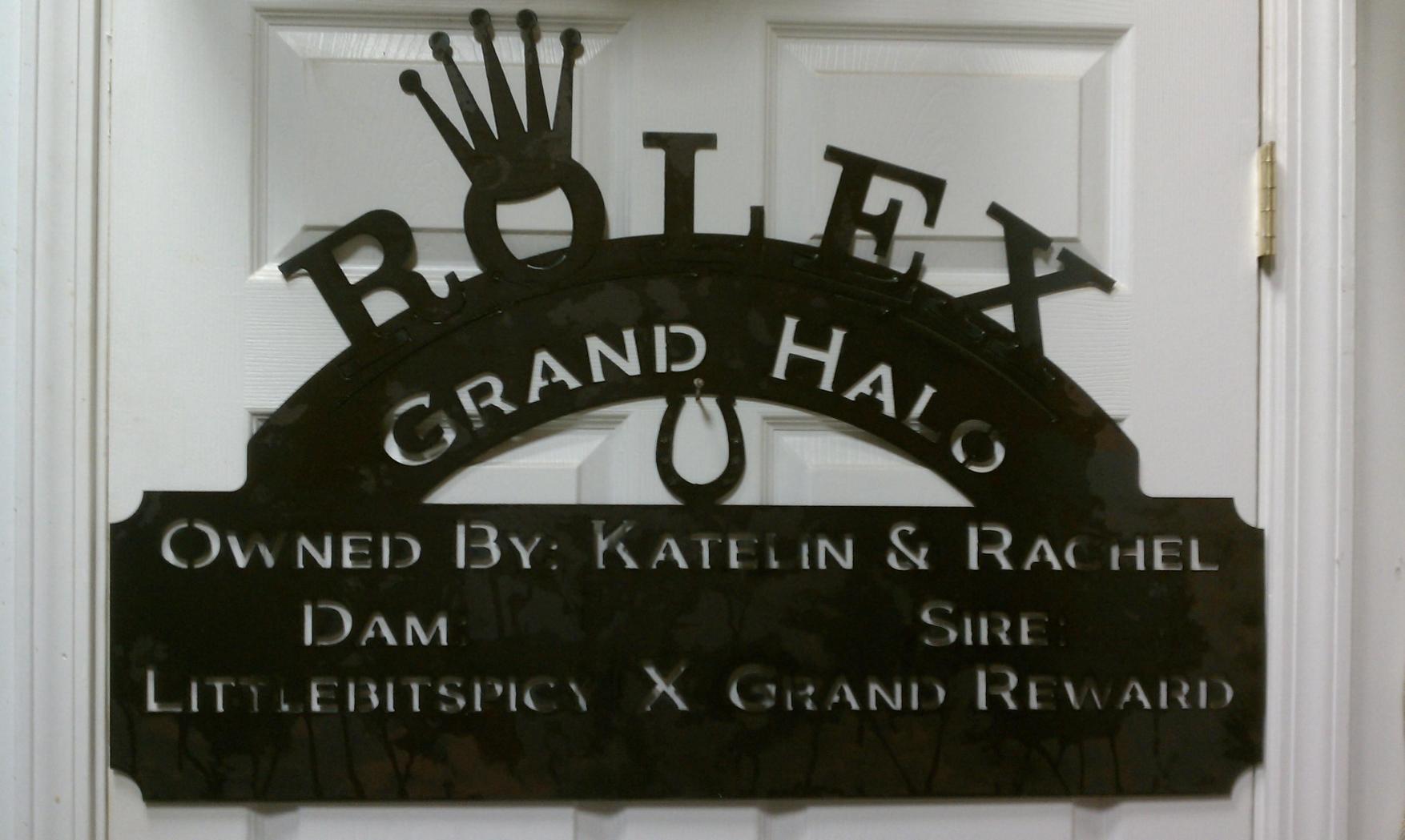

Made from 16 GA. carbon steel. Took somewhere around 3 hours drawing time and 24 minutes to cut. Cut on a my home-built 50"x96" CNC plasma table using the PP50.
Althought slightly warped due to the heat and thin material, it was kept to a minumum by spraying it with water while cutting. (No water table... yet)
The size is 36" wide x 24" high.
The horses name is Rolex. His racing name is Grand Halo, and the parents names are below.
