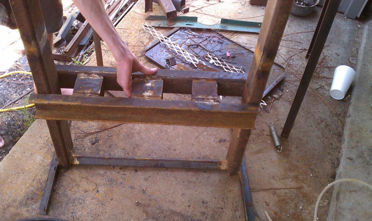

    Here are some pictures of the press. The middle bottom and frame. Not sure what order they are in cause I can not figure out upload.
    Top of frame

    base shelf

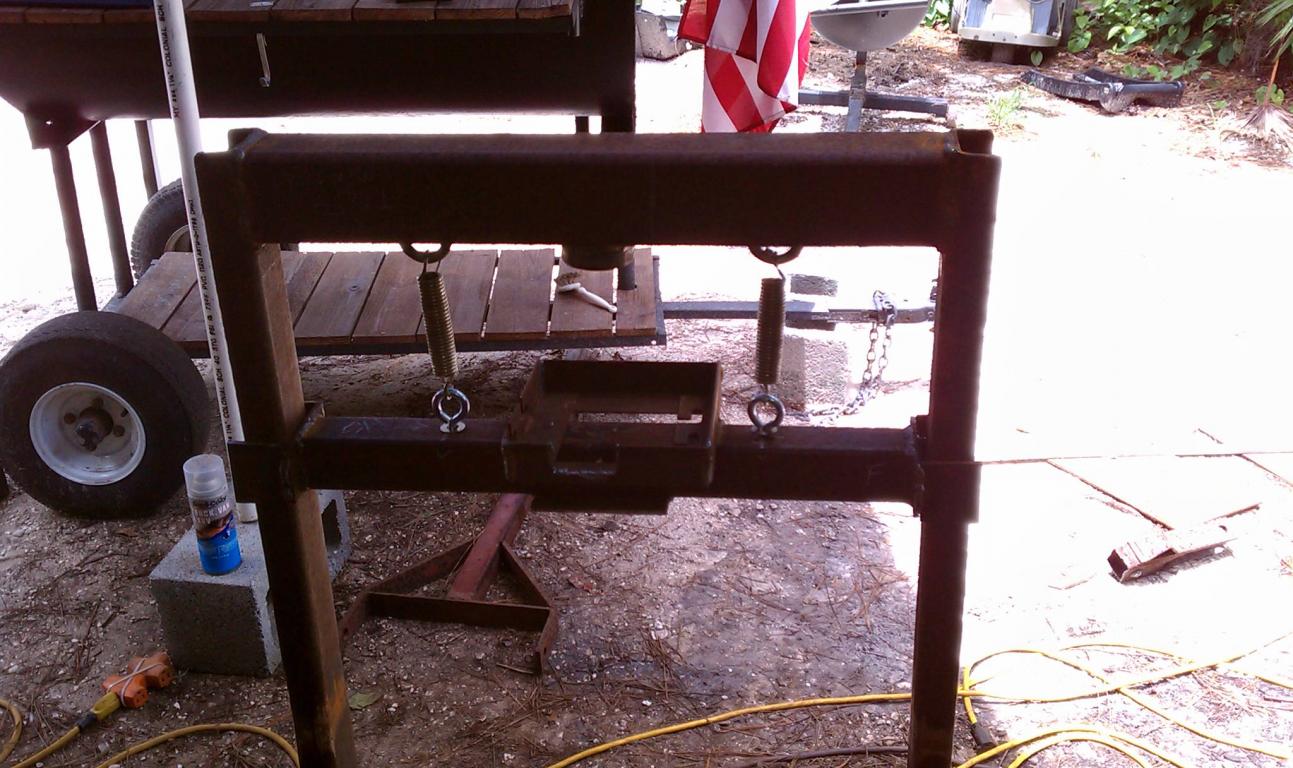

    Spring locations

    Complete no sanding no paint but can use it

    Brake added

    Well it got paint yesterday. Could not pick a color. Took hunter green and sunny yellow. A lot of yellow. Match the welders now. lol
    Added a place for jack handle

    The handles on the sides were bent on the press with the brake I made too
    Nice! What is the largest width you can bend? I would love to build one that could bend 3'-4' pieces of 12 gauge.
    So far 1/2" by 2 I have done with no problem. Last post I did in the brake thread was 6"x1/4" with no problem either. It is pretty strong.
