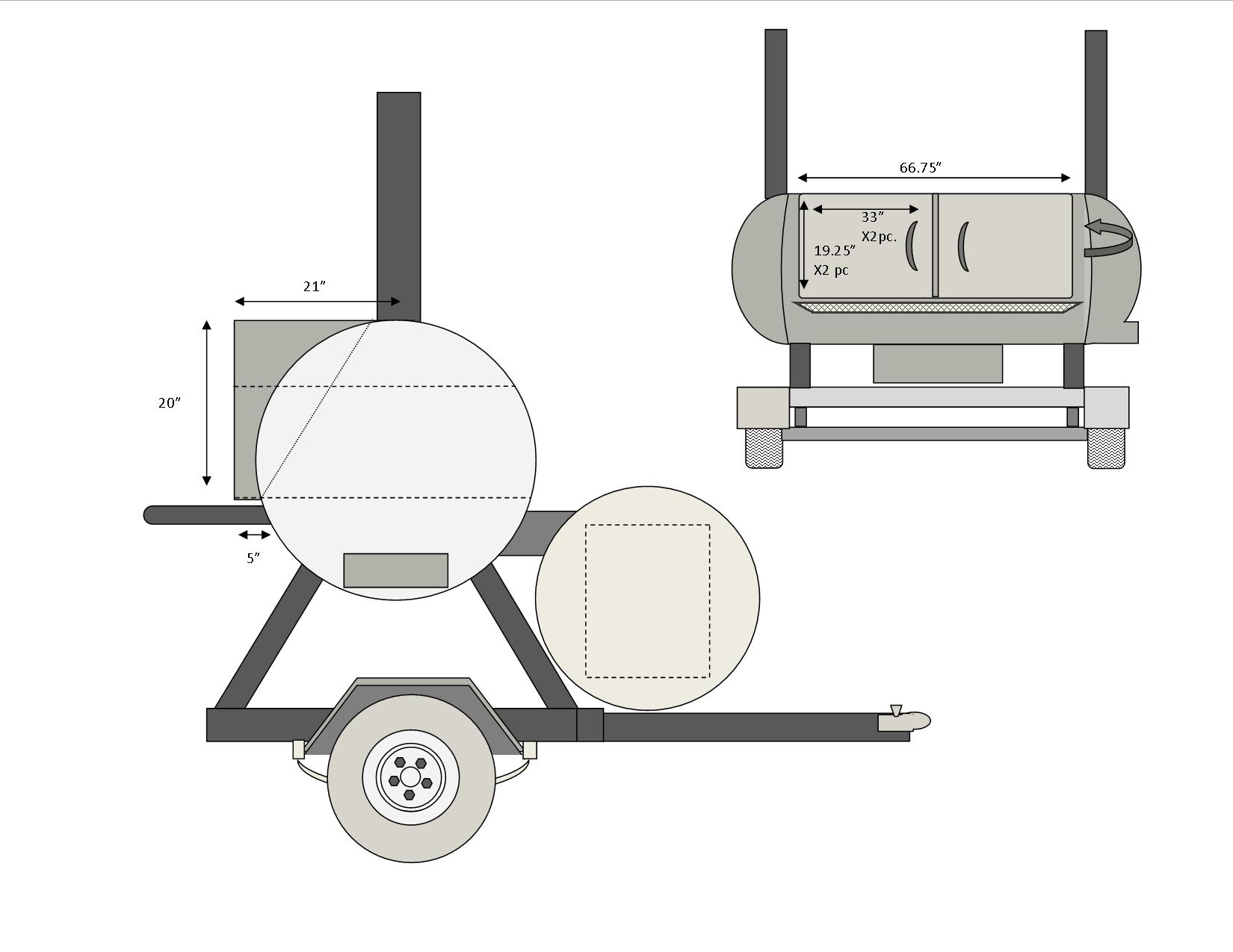

    From first hand experience, now over ten years building multiple grills and smokers, I would advise you NOT to use thin sheet for your fire box. Anything less than 1/4" will NOT last very long. In fact, my latest, I used 3/8". Helps stabilize the fluctuation and recover times too when you open the doors to the cooking chamber.
    I hope you don't mind the advice. I know you have gotten a ways on it...I did think that the castors were a little close when I first saw it...Consider reinforcing them up to the fire box. When you have the weight of the wood in the box before the meat is added, it could get worse again.
    One additional comment about the metal thickness, is that thin stuff warps and pops when it has a fire in it, many cases it will be permanantly warped. Doors and sealing areas are subject to different expansion rates and it is an ugly picture when you get done cooking for the first time or two. I'd say the frame around the fire box may actually do as much harm as good, because it will remain cooler while the fire box is expanding....Something to keep an eye on anyway.

  8. #28
    Designs are usually in my head. I think of them and build them from my head..But I just happen to have one in the works that I did make a rough drawing for the customer.Click image for larger version.

    I should be OK as far as heat goes. I'm not going to build a fire directly on the sheet metal. The box is 12 gauge and the smoker is 12 gauge, I did use a sheet of 16 gauge on one outside run. It will not take very much charcoal to heat the cooker. My last cooker was 12 gauge inside and 16 gauge outside with no insulation. I could cook 4 hours on a 1/4 bag of charcoal.
  10. #30
    The heat within the fire box from the fire will cause the metal to flex and warp badly. Its just not building the fire directly down on the metal that is the problem.
