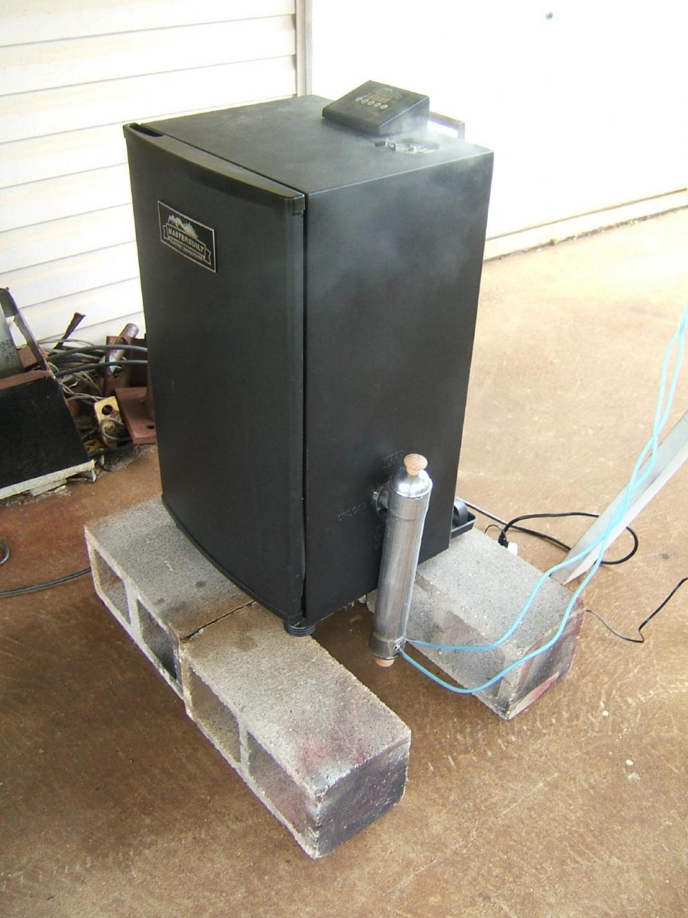

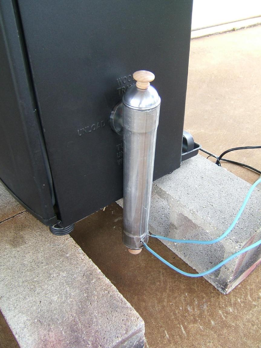

    Hi Smokers
    Here are sites I found great info about smoking.
    http://www.thesmokering.com/forum/index.php
    http://www.smoker-cooking.com/index.html
    I bought an electric smoker that is very easy to use but did not make very much smoke as designed. I found a mod a guy come up with and made one myself and it works great (see attached). The smoke chamber is an exhaust pipe with both ends swaged out to fit a fence post top I welded a grate just above the lower swage (round sheet metal with 1/4" hole all over). And a 1/2" pipe out the side near the top into the smoker oven. It is used to burn wood chips (maple, apple, or mesquite). The smoker oven supplies the heat for cooking and is temperature and time controlled with a digital display. The smoke chamber is lit and burns on it’s own. The original design has an aquarium air pump to aid combustion but I found just leaving the bottom cover of works very well the vent at the top of the oven supplies a draft to keep it burning.
    I’m sure the whole thing could be welded up in a home shop.

    Too cool Tom. I have been wanting a method to introduce smoke into my smoker without having to open the door. Now that the weather is cooler and thankfully wetter I know what I will be doing in the shop. By the way I highly recommend apricot wood for smoking. It makes a sweet smoke and great flavor.
