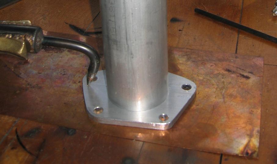

    Hey guys -
    I am really liking mixing in a little bit of Helium for additionally concentrated arc heat, for any thick aluminum.
    Here is a flange (1/4" plate of 6061-T6) fillet welded to an intake pipe (2.25"OD .065" wall 6061-T6 tubing.) I used 3/32" 4043 filler rod.
    Prepped for welding:
    After welding:
    I didn't cut the hole in the middle of the plate until after I welded it. I did it that way to reduce distortion. But having the 1/4" plate being continuous, meant it would soak up more energy during welding and require more power for welding.
    I used about 2.5 cfh Helium and about 12.5 cfh argon, with a #6 gas lens cup.
    I used a 3/32" tungsten truncated point (like a crayon), 2% lanthanted. Only the very tip melted/balled.
    I used 20% DCEP AC Balance (minimum on my machine.) The Helium seemed to really concentrate heat. It makes a puddle more effortlessly, and a deeper puddle, that penetrates much deeper, too. I set the pedal to give it everything it's got (200 amps) at full pedal down, but found that I didn't need to floor it. I probably used about 3/4 pedal to get the puddle going (maybe 150-160 amps?)
    This is for my racecar. I'll be doing some more boost tube welding tomorrow, and hopefully wrapping up a new, experimental intake manifold for it.
    Anyhow, really happy having some Helium at my disposal. It doesn't take very much to make a very noticeable difference!

    jackeru, was this welded with an inverter machine or old tranformer unit?
    also, did you use a pulse setting while welding this?

    Welded with my Everlast Super200P inverter, of course. No pulse.
    Since you only had to use maybe 150-160 amps? if you didnt have the Helium would you have been able to do the weld by flooring the pedal?
    sold my miller mig
    got a PT250EX
    saving up for a plasma cutter
    Able to "get the weld done" on pure argon, yes with more difficulty in manipulating the torch so that the filler rod and the thinner (.065" tubing) material didn't melt, probably could have "managed". But I would bet, it would have given a different quality to the weld bead. I'm thinking, the weld bead would have been more "built up" on the surface, with less "wetted in" look at the toes of the weld bead, the weld bead surface wouldn't be as shiny but may look more dull and grainey, and there would have been a wider cathodic etch pattern. At least, this is what I've noticed in some back to back tests on various gas mixes on the same material.
    Mixing in Helium is almost like twisting the A/C balance knob farther towards the "penetration" side (reduced EP%).
