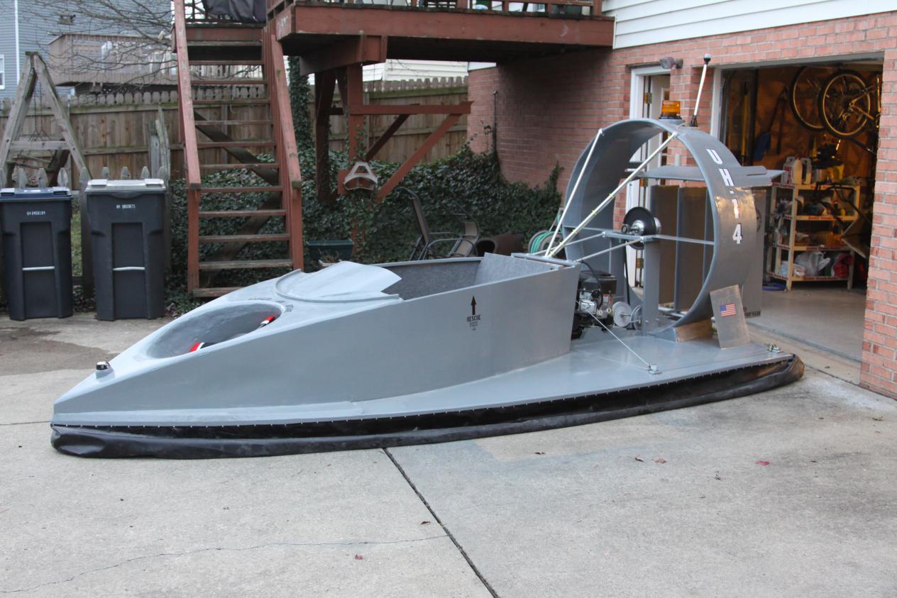

    Had a lot of activity trying to finish off the build. I've completed enough that I'll wait till spring for the little stuff.

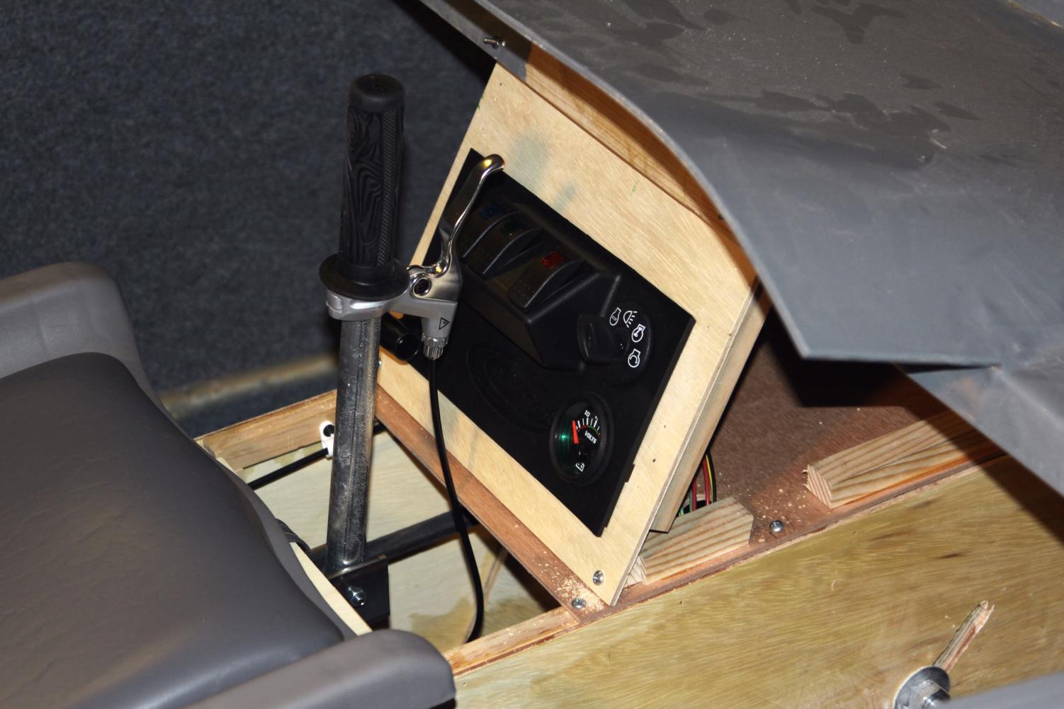

    The recent activity was to finish the steering and trim and the steering control. Then went from the temporay wiring to the final wiring. The choke is on the left with the ignition and voltmeter on the right. The switches are for the strobe light (required by the Coast Guard), the running lights and headlight (that aren't installed yet).
    I also have a tach, but haven't installed that yet.
    Lacking any inspiration on a graphic design - I went with the military look.

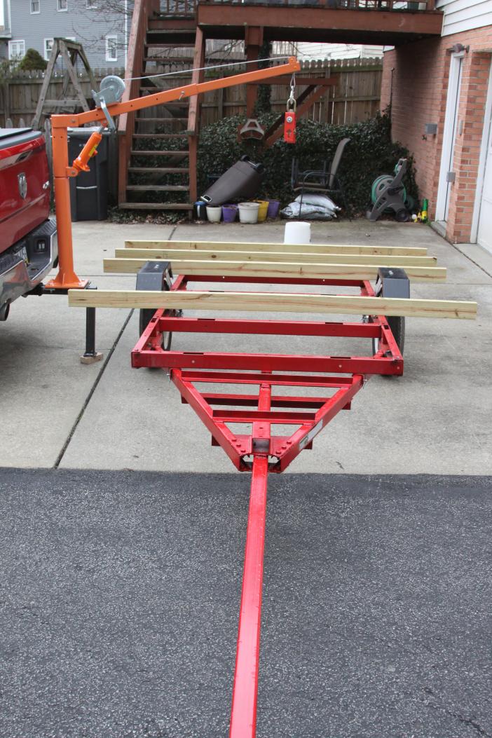

    I've been working on the trailer. I started with an HF 4x8 tilt trailer and have been modifying it. I welded a lot of the joints for peace of mind (and I like to practice my welding). I had to extend the tongue to fit the craft. I'm now building a wooden deck on it.

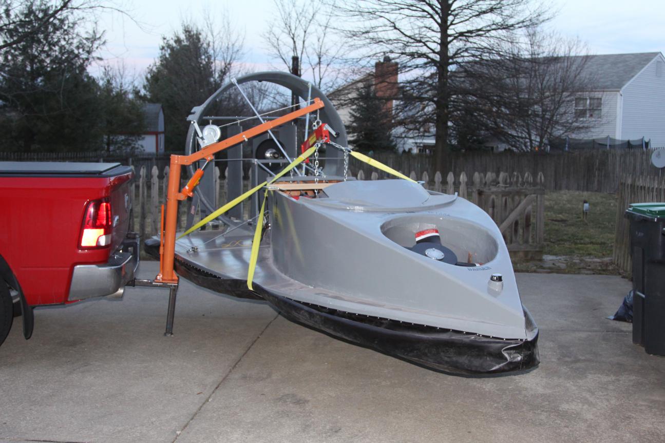

    To load it, the best concept was using a truck crane. So, last weekend I fabricated a hitch mount for it. The picture below shows how I expect it all to come together.

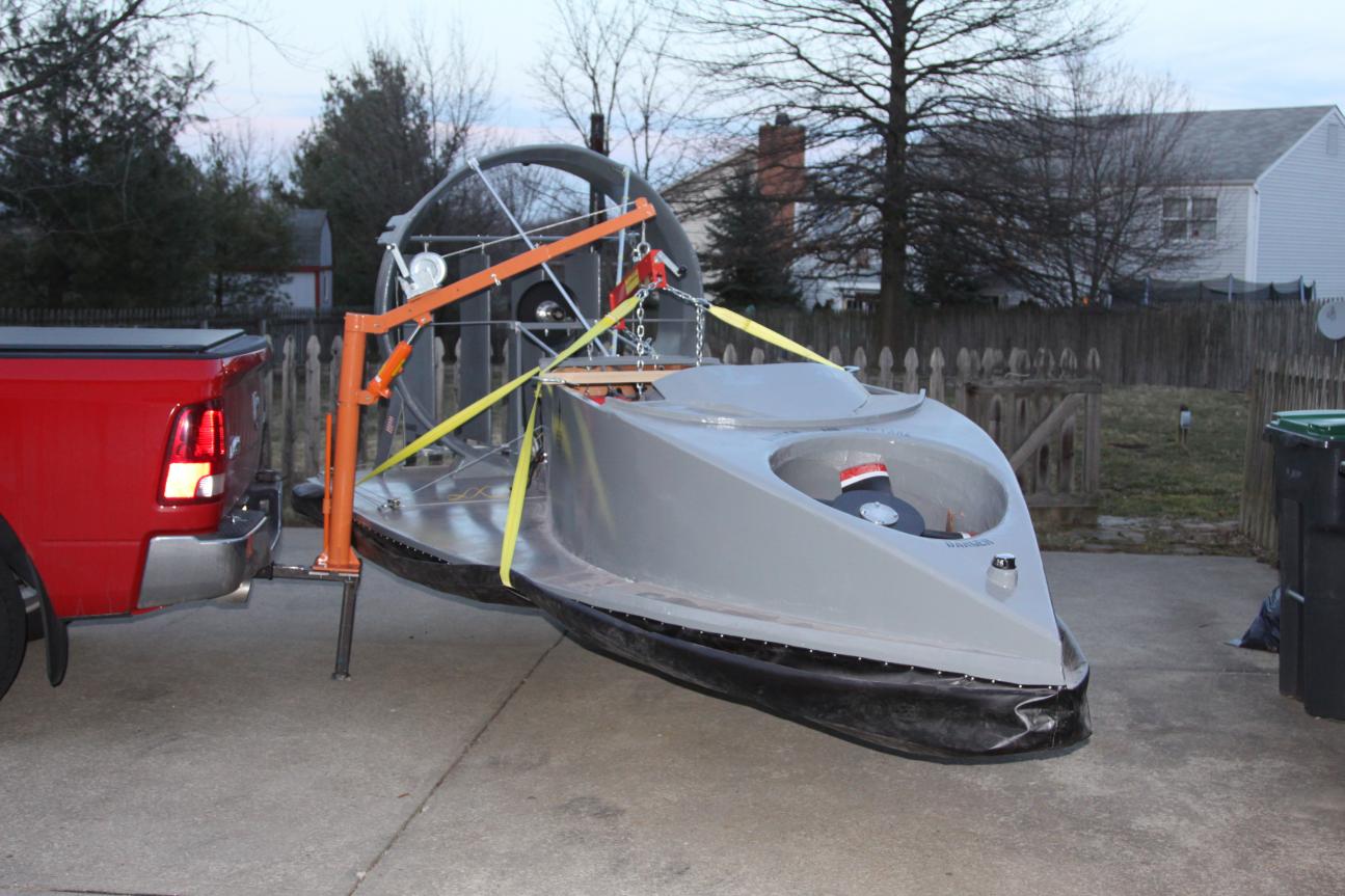

    Tonight it was warm enough and I got home early enough that I tested the loading system. I was pleased with how it worked. I may need to make some minor tuning adjustments, but the concept seems sound. Once the hovercraft is in the air, I'll just slide the trailer underneath by hand.
    After I put it down, I slapped the prop and it and tried powered flight for the first time. I only had about 10 feet of space, so it was a very short test. It worked! I had steering control and forward motion. But, when I cut back on the throttle - the belt for the prop jumpted the pulley. This has been a problem that I thought I had fixed, but I guess not.
