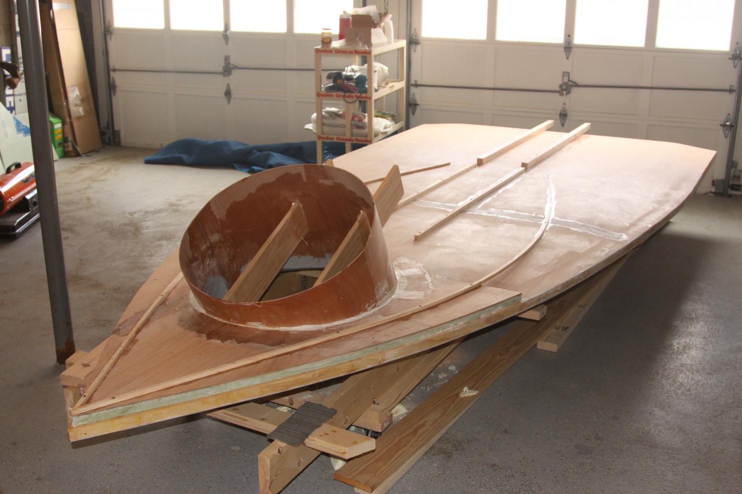

    Default Finish the bottom and lay out the cockpit
ID:	3311The first picture shows the bottom after it's been finished and painted. The skirt attaches on the unpainted wood on the edge of the hull and the inside attached on the wood strip at the top. You can see a hole between the inner skirt attach strip and the outer edge of the lift duct. That is how the skirt is inflated.
    The next picture shows the mounting strips for the cockpit wall and the center seat. The center seat also covers the steering mechanism and the lift fan drive belt.

    Jason,
    On the Universal Hovercraft site, they say you can buy the entire kit for about $3000.
    I'm just learning to fiberglass, so I've used more epoxy (suprisingly expensive) and fiberglass than expected. Mistakes also cost some. But, the biggest cost has been using the hovercraft as an excuse for tools. But, I'd have to say between $3k and $4k is ballpark. (I buy stuff as I go so that there is no big cash outlay.)
    The plans call for an 18 to 24 hp riding mower engine. Since the "American Way" is "bigger is always better" - I got a 26 hp engine. They actually said that is a real sweet spot for performance. You can go for two separate motors (lift/thrust) or one. I'm going with one and the fan and prop are belt driven.

    On a more technical note, do you need to use a special epoxy that does not melt the foam. I know some epoxies and glues can be pretty aggressive against plastics and foams and such.
    You can't use polyethylene based epoxy, it will melt the foam. I made a mistake and tried to use bondo fiberglass repair to fill a couple small holes. All it did was make a couple very bigs holes.
    I used a "standard" epoxy resin.
