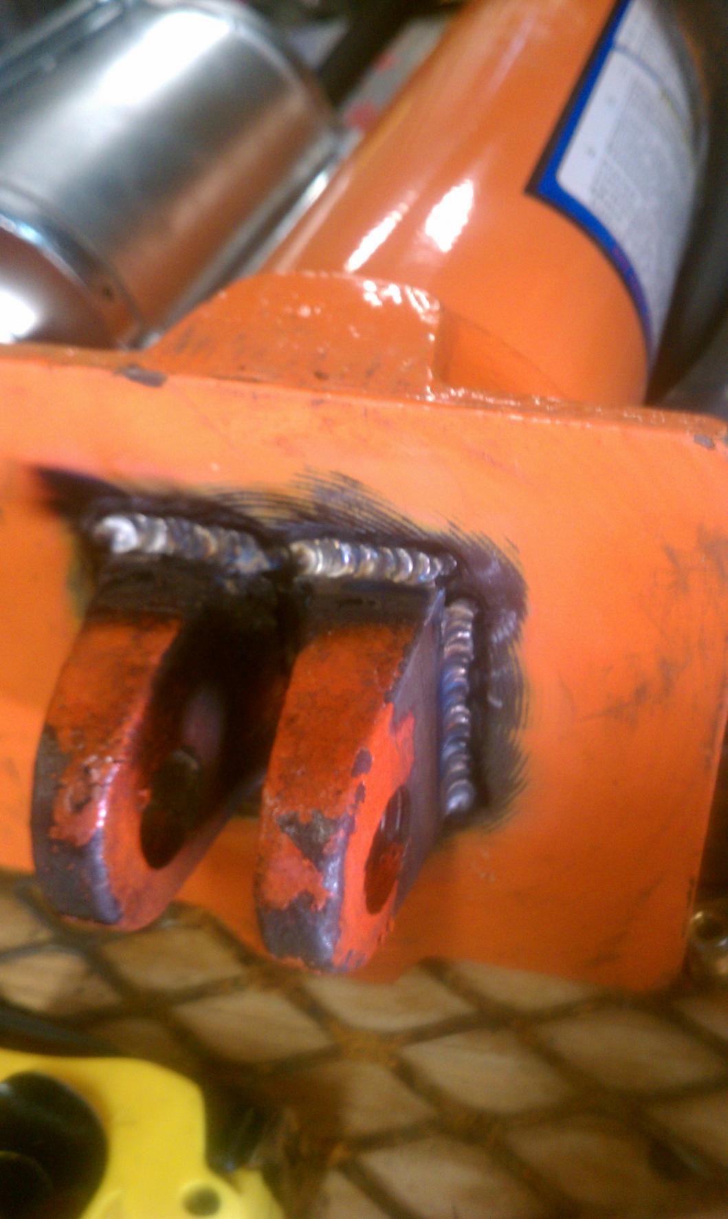

Hey there, as with most people I like to save money where I can . Today's project consisted of modifying a $40 ( $32 with coupon) air/hydraulic flat bottom jack into the equivalent $80 jack for use on my engine hoist.
$80 jack
http://www.harborfreight.com/8-ton-l...ack-94562.html
$40 jack
http://www.harborfreight.com/8-ton-l...ack-95967.html

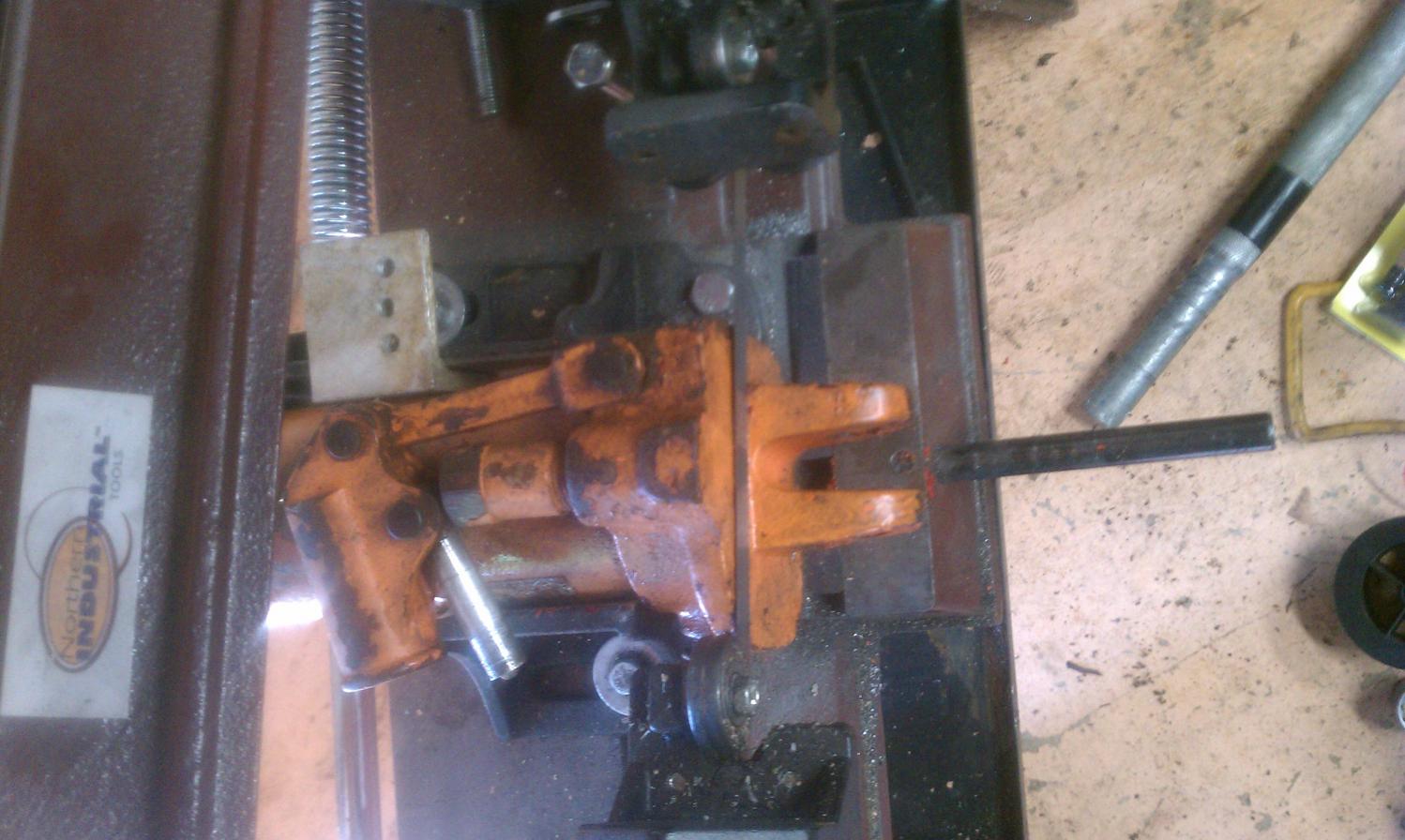

The only differences between these two, at least that matter to me, is the flat bottom one is not a direct bolt in for my HF engine hoist. So I decided to use my HF bandsaw, cut off the old flange and weld it onto the new jack. Keep in mind I was not terribly worried about perfect penetration since this part will remain in compression under a load.
Anyhow on to the pictures (forgive cell phone quality)
