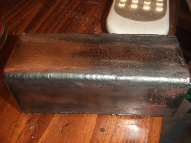

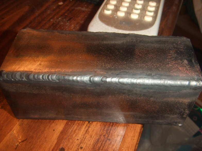

    Got bored today so I TIGed up some 1/16" plate into a square tube with the weldernator.

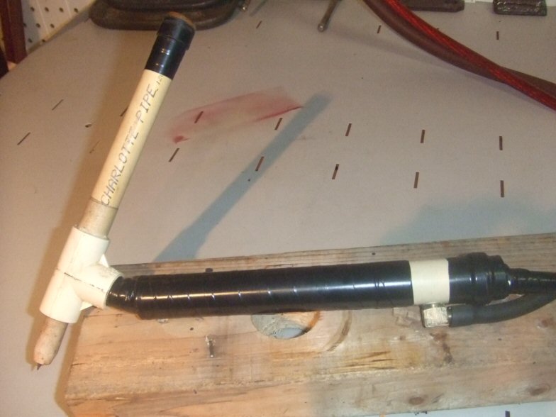

    I also completely redesigned my homemade torch and added a gas solenoid to my setup so I could ditch the torch mounted gas valve.

    How come the welds look kinda frosty? They look cool
    Sep 2011
    121
    I think it's the camera flash, they don't have quite the same look in person. I am using .035" ER70S-6 Mig wire as filler. The welds do look a little weird compared to other people's welds I've seen, the seem kinda dual looking.

    That's looking good! Welding mild steel it will have a little graying (discoloration ) on the outside of the weld!

    was that metal clean? it looks a bit dirty from the pics.

    Welds not too bad for a beginner.

    Thank you, all of you guys, it's very encouraging. I'm learning more every time I use it so I'm happy so far. I'm mainly practicing holding proper arc length and consistently feeding wire at the same time. I'm slowly getting the hang of it. Like I said, I've got about an hour total torch time. For the type of machine I'm using, and the homemade torch, it works surprisingly well. It is scratch start though, so that's kind of a pain. I did learn that 2% Lanthanated holds a blunted point better than 2% Thoriated, with the scratch start anyhow. Can't wait until I can afford a 250EX though cause I want to try my hand at some aluminum.
    My power source is a 90A Chrysler alternator strapped to a 220v 1.5HP Westinghouse motor from my air compressor. I'm powering the field with a battery charger with a rheostat to control the OUTPUT power from the battery charger. My foot pedal is a Phase-Angle controller from a sewing machine plugged into the wall and controlling the INPUT power to the battery charger. I set the max current with the rheostat and then use the foot pedal to vary from 0-Max. I just recently added a micro-switch to the foot pedal and a gas solenoid to control my argon. The brass valve I had mounted to the torch was heavy and made the torch really cumbersome. Also, on my original torch design, the head was 90* to the handle so I couldn't hold it properly, with this new redesign and the angled head, I can hold the torch properly and it's helped quite a lot. I really can't wait until I have a proper machine to use. With a few tanks of gas worth of practice, I'm sure I can be really good at this. If you want to see pictures of my machine/setup, I have a thread in the introduction section from a while back.
