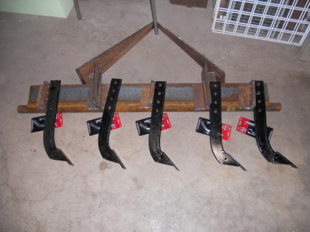

Since I have a big hole to dig for our greenhouse, I decided to make it so that the box was detachable from the scarifier so that I wouldn't need to worry about bucket teeth for the front loader. Plus, I can probably build a couple other things to attach to it as well. So first up, the ripper section:
The main cross support for the shanks consists of a 3x5 piece of angle welded to a 2" tube, mostly because that was what the scrap yard had on the day I went shopping.
This is the progress to date, all parts of the ripper portion have been cut out and the holes on the shank brackets are completed to the point where the belt on my drill press broke.
