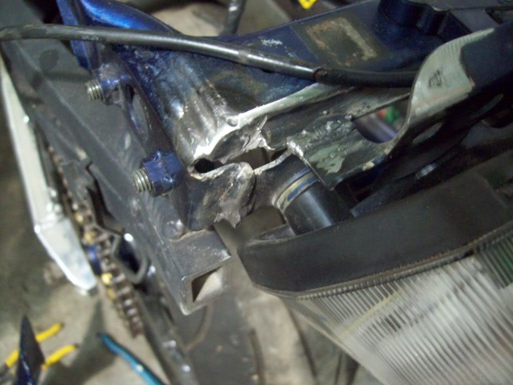

    busted *** plastics.
    had em glassed up tho. they're perfect.. well, for what they are. i had to do ALOT of work to get them to be useful again. the damage was extensive when the previous owner crashed it.
    i personally never dropped this bike

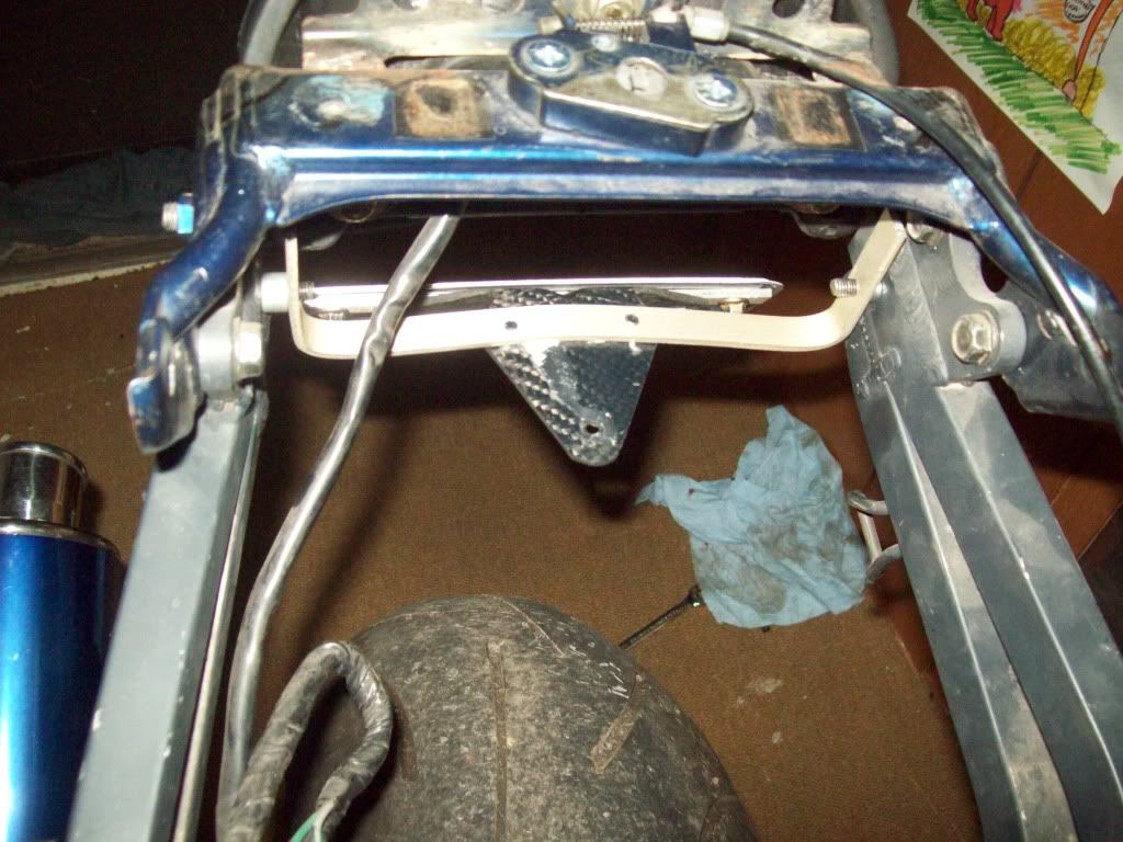

    lil metal magic. nice, simple tag bracket with carbon fiber hanger.

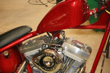

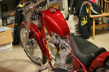

    I build bikes also. I'll try to post a picture.
ID:	268   Click image for larger version.
Name:	Copy of IMG_0465.JPG
