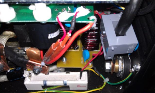

    Thanks for the help everyone, I found out why the plasma torch wasn't working to well while I was checking the spark gap. See below.

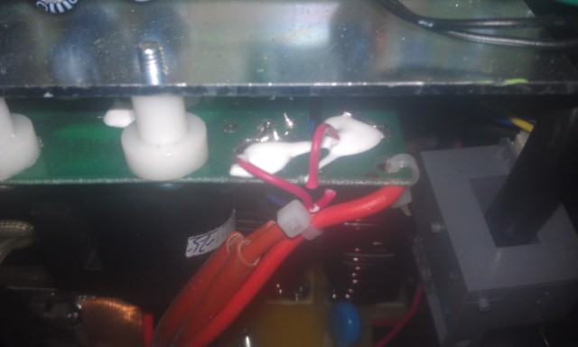

    It was a easy repair and now it cuts very well

    Your will probably want to re-locate that cut wire if you can, the cover louver/vents cut it (sliced on the circuit board) when the cover was taken on or off. Or you can just remember to expand the cover at the bottom then you need to remove and replace it (what I do).

    Thanks Mike, Yes I tried to figure out another route for the wires but there is no way to move them as they are too tight. I'll get one of the dryers you mentioned asap.

    As long as you remember to expand/fan out the bottom if you ever need to remove the cover, you really should never need to take the cover off. If a unit took a hit in shipping on that side there's probably a chance it could do what you had too. But glad you got it fixed.

    I've been a electronics tech for 20+ years so the repair was simple, I investigated slightly notching the circuit board and tack the wire in the notch with silicon but decided against that. I'll do what you do and expand the cover if it ever has to come off again.
