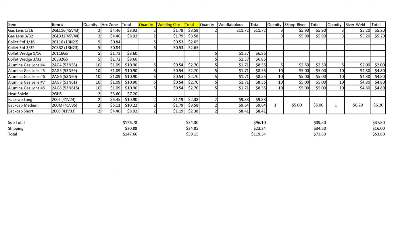

    I am planning on getting the wedge collets. Here is my online shopping comparrison between, Arc-Zone, Welding City, Weldfabulous, 3Shop-River (ebay) and River-Weld for 2 series consumables.
Name:	Tig Torch costs.jpg

    The torch comes with a medium backcap.
    Once you use the wedge collet you won't go back to the regular ones.
    Weldingcity has a good deal on 2% lanthanated tungsten. 3/32 will give you the most milage.
    I have never had a problem with the standard 3 series collets but want to try thr wedgw collets. What diffrences have you seen? Pros/Cons?
    I have never used lanthanated just pure and ceriated so maybe I will give them a try.
    They fit better allowing the gas lens to be fully seated into the head and the backcap will lock your tungsten just as the oring seats. They're made of brass and should last for years of hobby use. Well worth the extra pennies IMO.

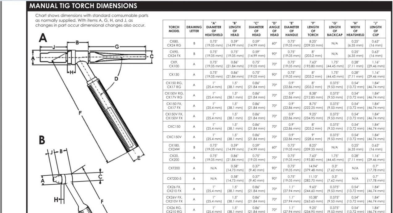

    Just wondering, what's the difference between a 9 and a 130, other than the 5A on the 100% duty cycle?

    Head angle is all I see. It's 70 degrees for the 9 and 90 degrees for the 130. Click image for larger version.
