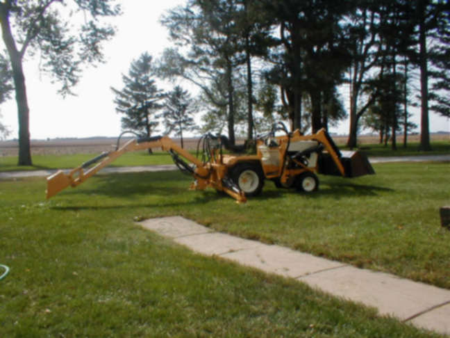

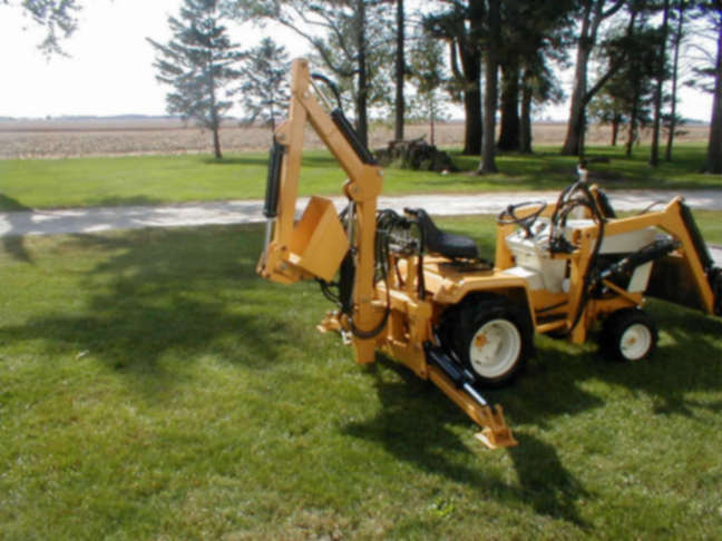

    Here is a cub cadet 1250 that I added a backhoe and a loader to. This project took me about 3 years to complete mainly due to time and money. All the hydraulics were purchased new. Every pivot point has a grease fitting. I also added power steering as well. Total cost of the build was around $4,000. I made 3 different size buckets for the backhoe. I have a 7", 12" and a 16". This machine will dig 5 feet deep. Overall I'm very happy with it. It has been very handy.

    Nice looking workmanship.
    How well does the pump keep up while you are digging? How big is that FEL bucket? It looks quite monstrous compared to the tractor!
    Great work. Did you have another tractor sitting nearby to look at or did you do everything from scratch?
    What size engine is on it?
    It does seem like a fairly light chassis to have all of that on it. Does it dig / lift OK without walking around too much?
    looks nice. Are you going to put teeth on the hoe bucket? What kind of reach and depth are you getting?
    The Bucket is 42" wide and 16" tall. The hoe can dig 5 feet deep and can reach about 8 feet. The engine is a 12 hp kohler and the hydraulic pump puts out 8 gpm at 3,000 psi. I have this regulated back to 1,800 psi. I have added teeth to the backhoe bucket. The pump has no trouble keeping up with the hoe when it is digging.
