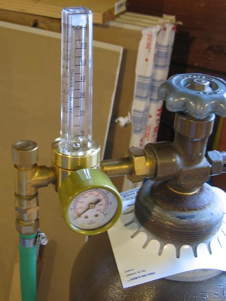

    I "rolled my own" dual outlet flowmeter that had two outlets and two flow adjustment knobs / needle valves, and found worked very well and was inexpensive, but it only had one floating ball gauge that both flows would share. I bought a second $35 flowmeter, and a 1/4" NPT "Tee" fitting to build it.
    Edit: I thought I posted it up here somewhere, but after a few minutes searching, couldn't find it. So here is a pic:
    Hopefully it's self-explanatory, but let me know if you need any additional info on it.
    I used the flowmeters parts sold by HTP (they are good quality, or you can buy a whole new flowmeter for about $35-$40 from them as well) and a 1/4" NPT Tee fitting that from Lowe's.

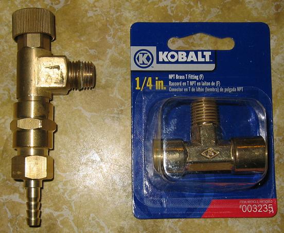

    here are the parts added to the single flowmeter:

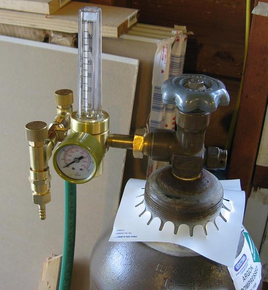

    Here is what the single flowmeter looked like before the dual modification:

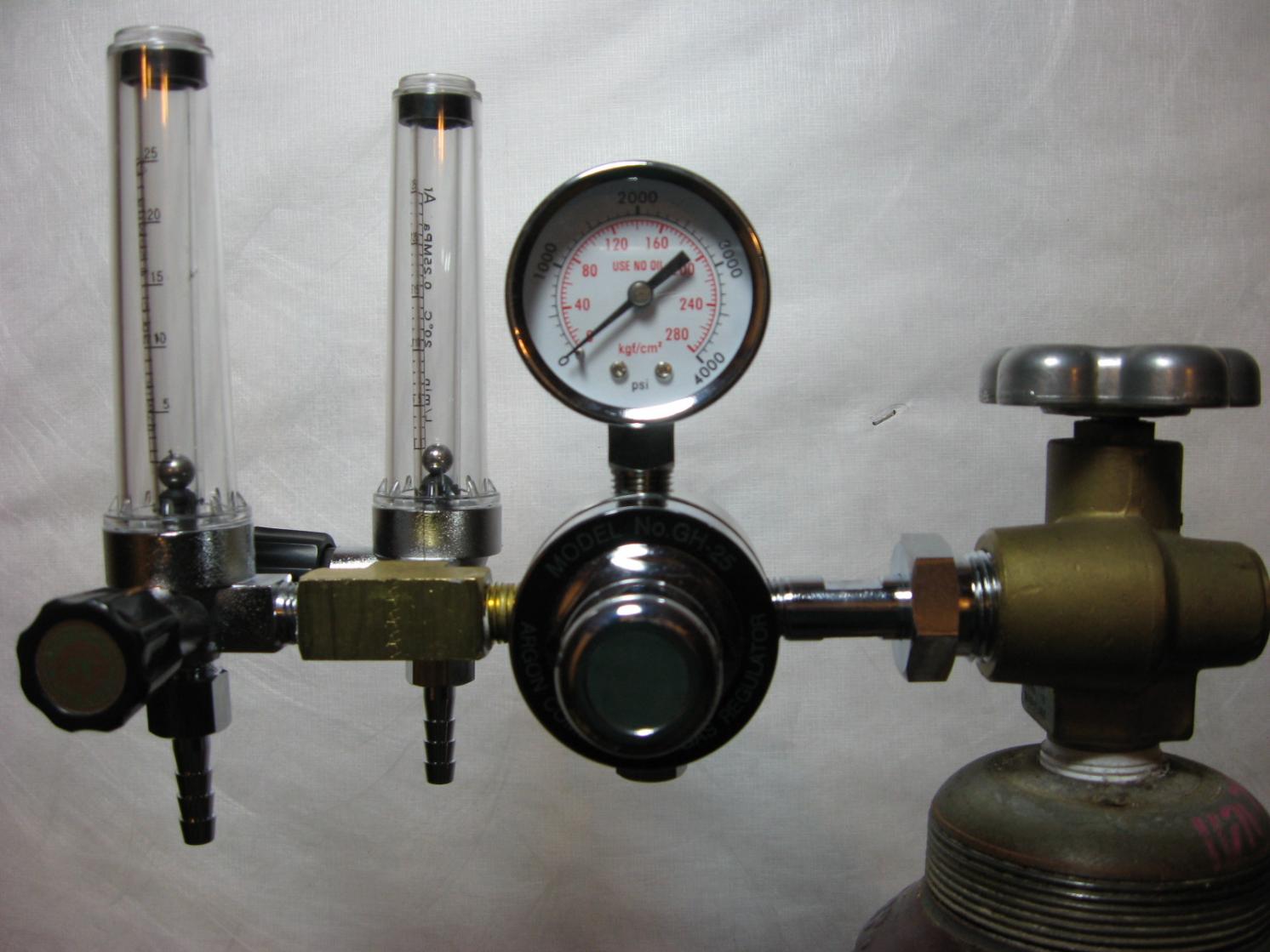

    I found a solution for independent adjustment... Click image for larger version.
ID:	4197 I could have used a better looking tee but this works just fine.
