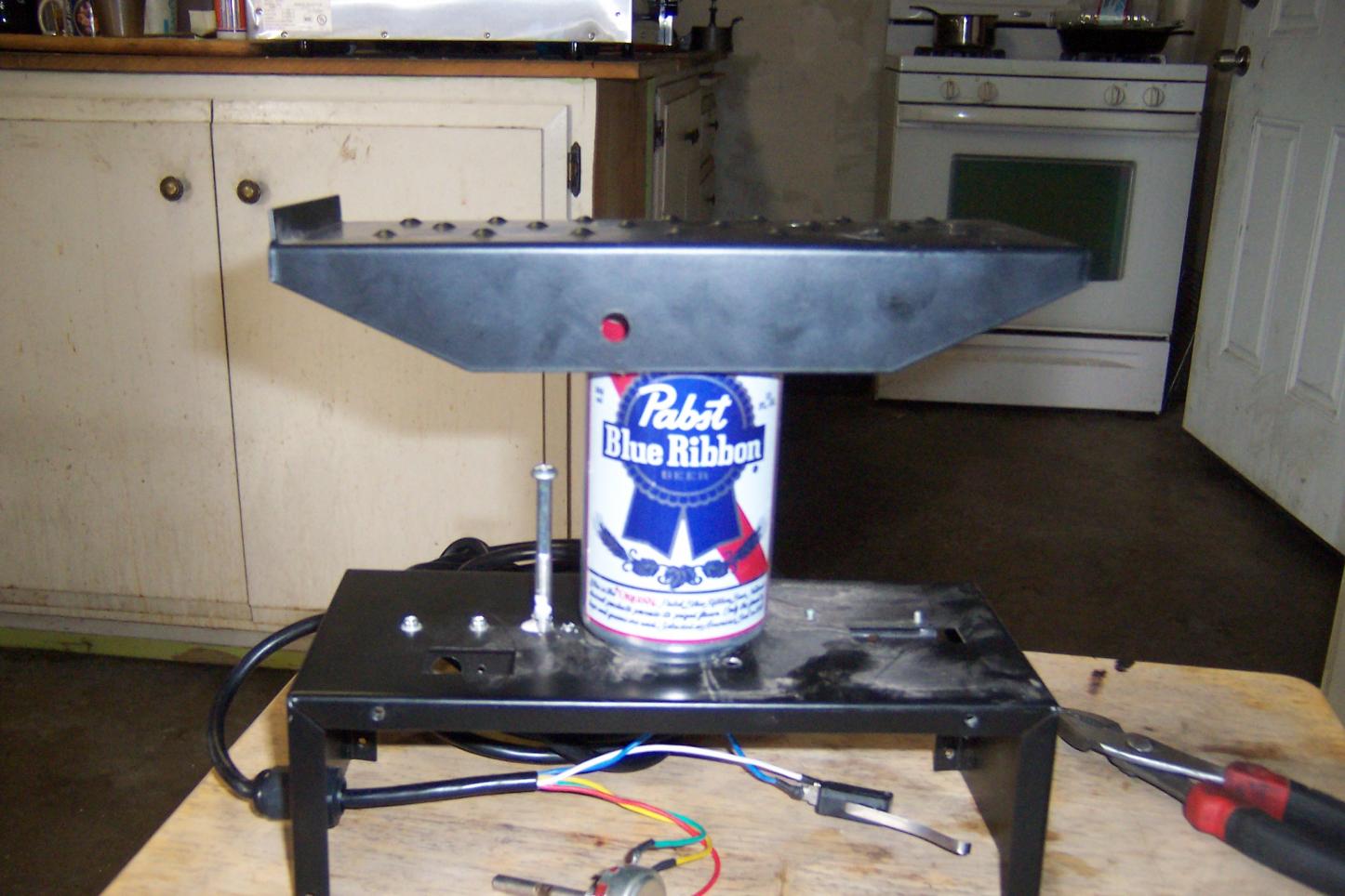

    Hey i fixed my tig welderClick image for larger version.
ID:	6462 foot pedal lol works good as a beer can crusher lol
    Having the pedal is kinda of a big deal, how do I fix this thing?
    Thanks,
    Nick

    47K. Did you open the pedal, sometimes in shipping, the cog will skip a couple teeth and sometimes the pedal is zip tied close for space and this will ramp the power up if it skips.
    You should have 1-2 (switch). 3-4 and 4-5 are the pot. Should be low ohms to 50K on one set and opposites on the other. Check that before changing the pot out.
    I did. I was wondering why you repeated yourself!

    I messed the part where you said you tested the pots. What does the pot do. Never had a back one myself?
    There is the pedal pot, and the front overall amp adjust.
    I found a broken solder joint on the 3-4 pin, and resolderd it and the pedal works.
