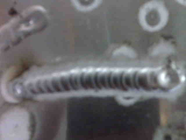

    ive been looking for a dinse water flow thru coupler for my new 200lx welder so i can hook up my 25 ft water cooled torch system to the 200 lx so i can take it on the water and build tuna towers using a flex head wp 20 torch which is very vesrstiale while climbing up the tuna tower and welding for hours and by the way the welder does weld pretty goodClick image for larger version.
