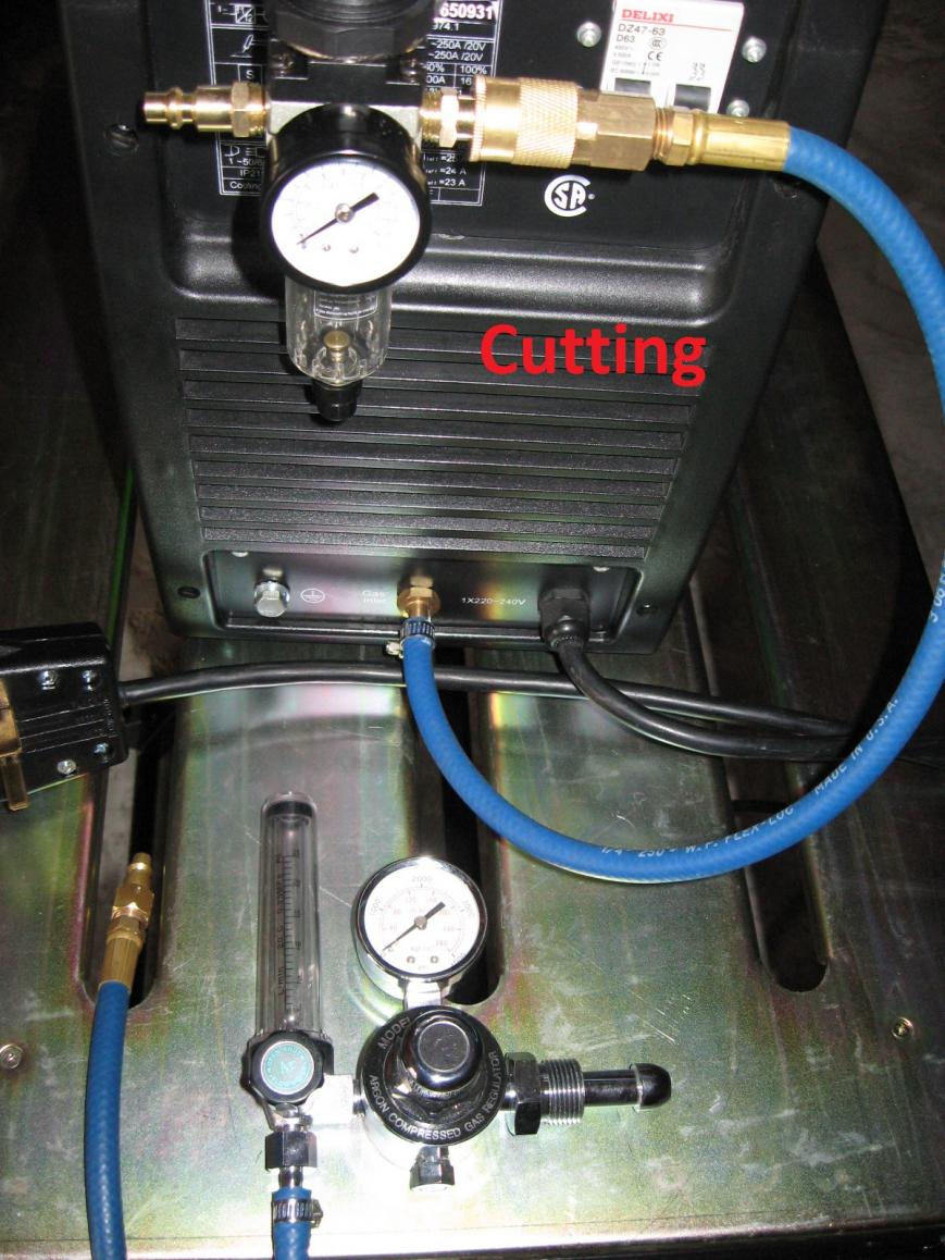

    Does anyone know where to get valves so I can hook up air and argon together, shut one off and open one so I don't have to keep switching hoses.
    Most people just use those quick connects that is used on air compressors and air tools. Ya dont have to turn it off between switching just pop one off and put the other on.
    Gabe
    everlast power arc 200
    lawn mowers
    You could also just put a Y in the inlet hose with a valve on both lines turning one on and one off. But the other way is what the majority of people do.

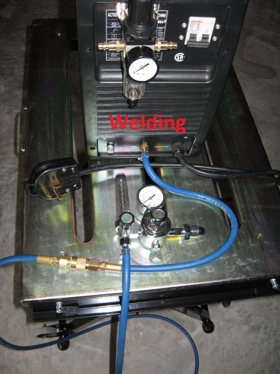

    Quote Originally Posted by ChadP View Post
    Here's my setup...Click image for larger version.

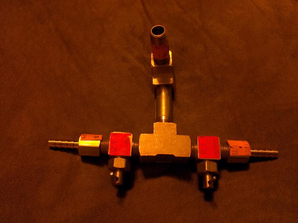

    That is pretty slick, but it seems to be intended for mixing gases. Something like this http://www.drillspot.com/products/39...101_ball_valve would probably work, but I would consider using a check valve on the argon line to prevent back pressure from slamming the regulator when you switch over.
    Redbeard is right they are mixing valves just thought it might work for this purpose. I did not think about the air preassure banging the argon regulator I think this would happen with any valve .zoama585 method is probably much safer and less likely to damage anything.
    Bill
    And it's cheap too !
    I used some barbed pex valves and a 't'. I'll take some pictures tomorrow.
