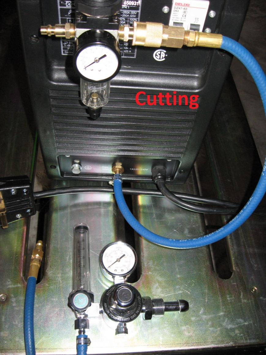

    Was a little disappointed to see how the 256 compressed air and inert gas was plumbed...both use the same nipple. This clearly wasnt going to cut it...talk about a pain in the ### to switch processes. Went to the hardware store and bought about $50 worth of brass fitting and made a T with ball valves on each side of the T, now all I have to do is turn the ball valve handles.

    I use regular quick couplings like the ones used on compressed air systems.

    Looks good!
    How does that regulator attach to the machine? Also...does the supplied regulator dry the compressed air?
    Quote Originally Posted by tnc110 View Post
    Looks good!
    Comes with a bracket and screws that are too long (regulator side). I cut the screws down to fit. To dry the air, I use a Motorgaurd M30 or M60 (M100 kit) only difference between them is inlet/outlet size. All use the same filter...this kit comes with one in the housing plus two spares...http://www.google.com/products/catal...ed=0CHsQ8wIwCw
