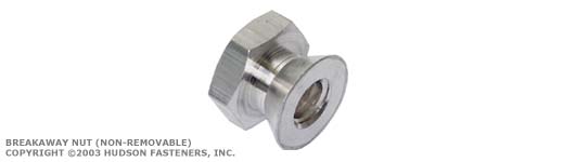

    want it tamper proof these are the only ones that are a big pain to undo http://www.hudsonfasteners.com/sec/sec_brkwynt.htmClick image for larger version.

    Wicked. I'm assuming you torque them down and the top breaks off?! Leaves a nice sloped crown that vise grips can't grab onto. Very nice ..... Bookmarked that site too!

    all the new cars use these for there steering columns and ignition locks a pain to get undone . yes tighten till they snap , the way to get them undone is with a welder sit a nut over crown and tack weld to get undone

    Can't wait until I start to *think* like a welder .... Caught myself in another thread when I said "bench" and was thinking of a wooden woodworkers bench and the rest of the forum was thinking welding bench! As you remove these by tacking a nut on, my first instinct was to dremel a slot and try a screwdriver (but I suspect the nut might be too tight for a screwdriver to work on it). Tack a nut on, that's a great idea.
