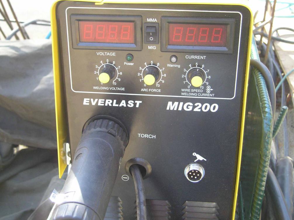

    I'm Wally out here in the hinterlands of Rainier Washington. I purchased a new model: MigMag 200 welder and I like it but there are a few problems I am having.
    One problem is that I have burned up the tips and need new tips, but don't know where to get them. Airgas doesn't carry them anymore and I have called the Everlast importer in San Francisco - Alex, but he seems too busy to return my phone calls. I have called him about 6 times but no answer back. I'm fairly sure that other people who buy this unit will need tips also, so what to do? If I can't get tips for it I want another style welder.
    I am also having a problem with the welder red light coming on in an overheating warning. Oftentimes it is when I just start welding so I am fairly sure that it really isn't overheating. What I have been doing in that case is flipping the on/off switch to reset the control.
    I also bought an Everlast Supercut 50. I was burning up tips on that unit too until I asked around here at various welding shops and was told that I have to put an air dryer in the line (I think that the Everlast manual should say something about that but it doesn't). I put that in and now it is working good.

    Post pictures of your unit so we can see which gun you have. There are some differences. Please also post pictures of your gun, so we can match up your parts, since it seems that the information you have given is a little off.

    Default pictures of my welder attached.
    I've never gotten parts from Airgas. I bought my equipment through Richard in the Seattle area and he said to contact Alex for my parts. Here are pictures of my unit. Do these help?

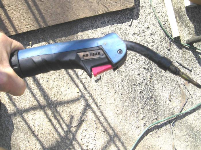

    Default another picture
    here is a pic of the stinger...

    Country,
    This is a Binzel gun. It is a standard make gun. It can be ordered from airgas. I believe that some of the parts are interchangeable with Miller, but they are standard Binzel and are easy to get locally, if you ask for them. They should also interchange with TWECO, according to information that I have. So, I don't know if your gas store guys are jerking you around, but I believe they are.

    The updated Everlast manuals online do say to add an air dryer to your plasma cutter. Download the powerplasma manual from the website. The info is on page 16. It applies to Supercut as well.
    http://www.airgas.com/browse/product...Keyword=binzel
    These Mig guns are authentic Binzel brand name. We switched to them, it made the cost go up but it has been worth it in the fact they are trouble free and parts are available state side, so our customers don't have to buy from us and can source parts locally. This has been our focus so that our consumables are easily sourced locally for most of our customers. These mig guns are far from the cheapest on the market and have given excellent service. They are ergonomic and well made.

    Mark - I took the stinger to both local shops that specalize in welding equipment and neither of them handled this set-up. One of them was Airgas in Olympia. They used to handle it but not anymore.
    The leads for the welder - I have it set up through number 8 wire. The pigtail on the mig is number 10 so 8 should be more than enough. What do you think?

    Country,
    If you will follow the link, it is the airgas site. Anything you want can be ordered through them...They are feeding you a line. The product will be special ordered, but they handle it. Or you can order it directly on line...but you can from us as well.
    I have airgas here too, but TWECO is the most famous and STANDARD parts. The parts should interchange. If they say they don't deal tweco, the they are not telling the truth....In fact, I bet they have a whole section dedicated to tweco parts. Take your gun in with you, tell them you want to see the tweco parts and see if the parts won't screw in and the nozzles slide on.
    I am willing to bet they just don't won't to deal with you because you didn't buy from them. You will have to win them over, but a little insistence goes a long way.
    Thanks Mark. I found my mig tips and shields at Harbor Freight in Olympia and they work great. I love this welder. I'm still getting used to it. Not sure how to set all the controls.

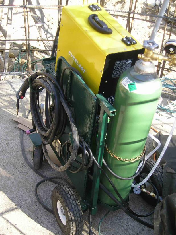

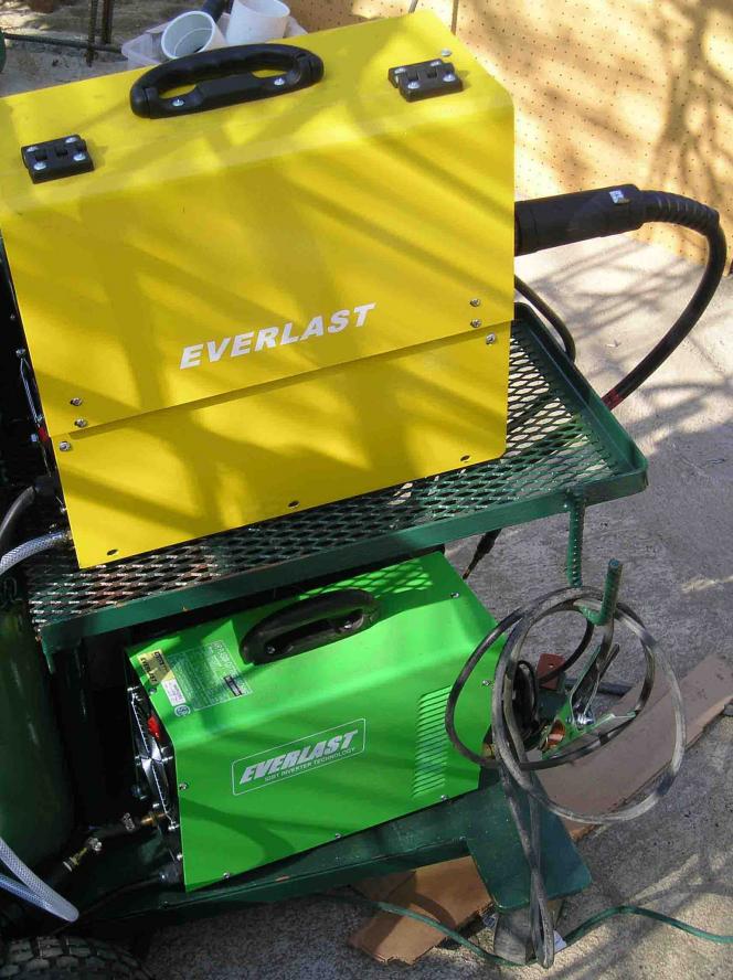

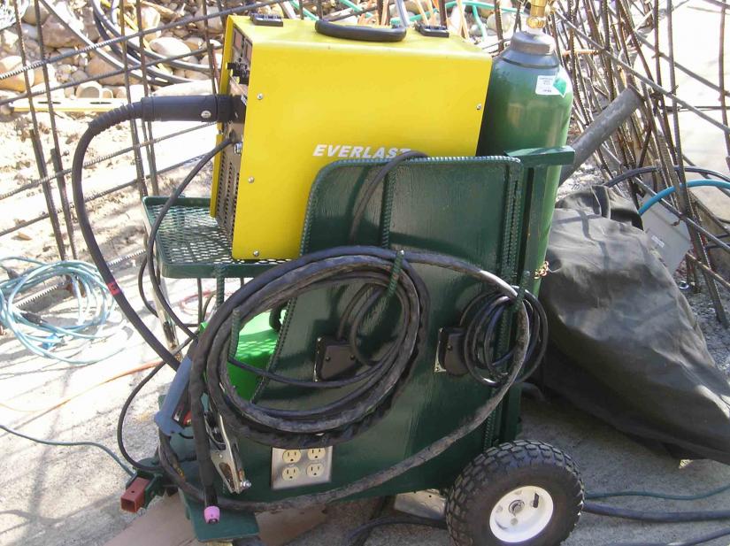

    Default welding cart
    Hey Mark - would you like to see my welding cart I made up? I'm not a pro at this, so bear that in mind. I'm attaching some pictures - I'm not sure how they will turn out as the file size may be a bit large but I could upload them another way...
    The two machines I purchased were the Mig/Mag 200 and the Everlast Super Cut 50. What I did was to put plugs on them that matched my stick welder outlet in the garage. So I have the cart wired for these outlets and I just have both machines plugged into the cart and then the cart plugs into the garage pigtail. I also put a 110 v. outlet on the cart for grinders etc.
    I will put the consumables - tips and things in a box on the lower shelf. I have several hooks on it to wrap leads and things. Then, borrowing from my auto upholstery days - I sewed up a waterproof canvass zipper type cover for the whole thing so it can sit out in the weather on a job if necessary. One thing I wished that I had planned in there was a place to put my helmet.
    -Wally

    I still think that you will find that either a Miller or Tweco nozzle and contact tip willl fit.
    That is a good cart...But, I recognize those tires...Good luck keeping them inflated. The idea is good for the oversize wheels, but those HF wheels will go flat if you even dare to look at them...To late. I just did. Better get out the air compressor....if they are still on the rim. lol.
