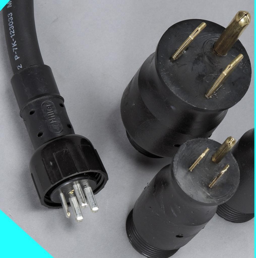

    Yow I bet if you plug your toaster in with that baby in make real dark toast. Be better to build just the opposite as this looks dangerous to me. I know you won't but you never know when a not so bright friend shows up and look out.
    Bill
    It looks almost like a 30 amp twist lock, which should be sufficient, more than to say the least. That's very similar in reality to the connection system Miller uses...Have you seen the size of those pins? Small.
    I want to make a cable like this but am a bit lost as to where I might find the plug and receptacle (without being robbed blind). Also, been looking around and there seems to be a big jump in price from 10 gauge to 8 gauge wire ...
