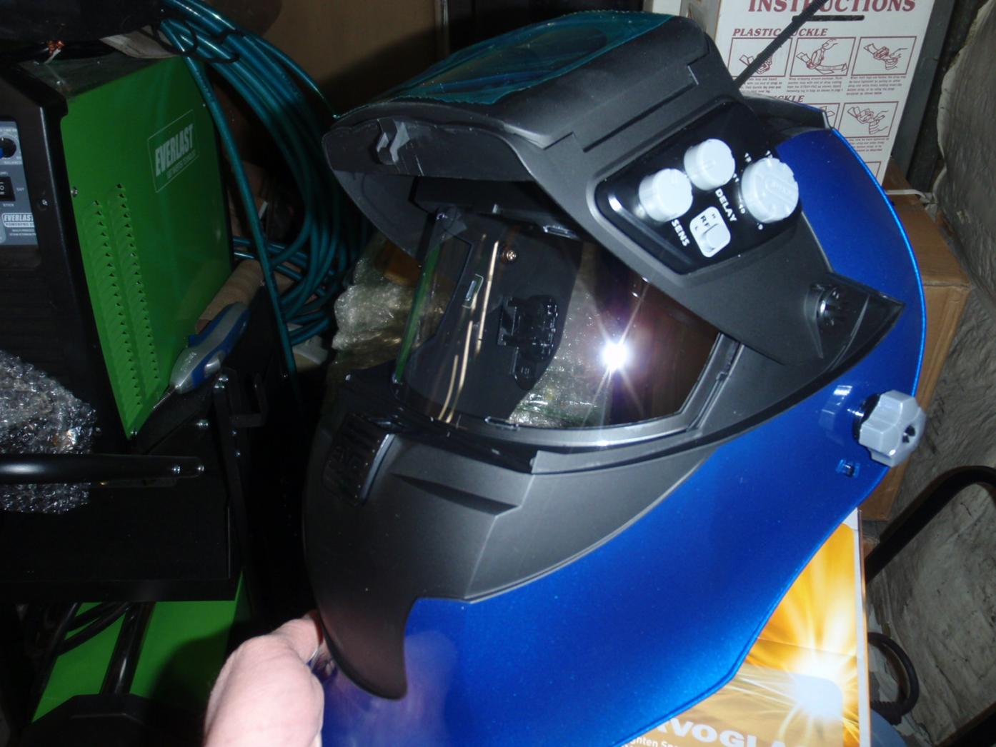

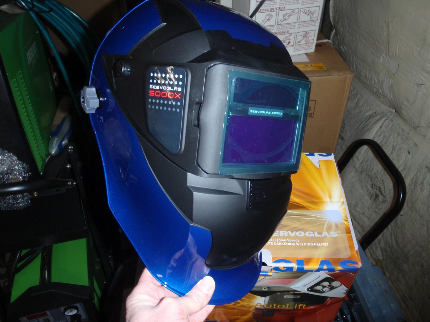

    Well at the risk of making a shameless plug for another product. here goes.
    I have used many auto darkening helmets over the years and have never found one I considered perfect. Especially with Tig welding the arc is so stable even the best can flash you in the right circumstances.
    However I have a helmet now that will not flash you!
    I have owned one for a couple of years now and have found this is the only helmet that works even in bright sunlight while Tig welding.
    How? It contains an RF sensor in addition to the light sensors.
    What this enables the helmet to do is detect the arc before it actually starts, and maintain the shade as long as the current is flowing as well as the traditional method of detecting the light.
    I have found it works extremely well and is very well built. Other cool features are a flip up lens and full grinding shield underneath, external controls for shade, delay, sensitivity, and Rf high and low. All parts of the helmet are replaceable and there is a hard hat adaptor available.
    Of course it comes at a price, but it’s made in Korea and for the features it’s a good value at the price.
    If anyone is interested I have a few in stock and will give a price break, and free shipping if you mention the forum. Retail on the unit shown is $380 and comes in Red, Blue and Silver.
