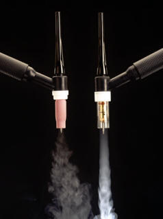

    I don't understand what you mean. Are you saying you can stick the electrode out farther with or without a gas lens?
    You can stick the electrode out farther with a gas lens since it directs argon out of the torch in a smooth straight column... gas lens on right>Click image for larger version.
ID:	5141<picture from CK Worldwide.
    A picture is worth a thousand words!
