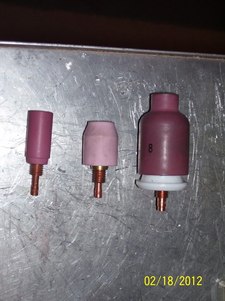

    I posted a picture of the 9/20 torch large gas lens and one with all of the 9/20 setups for reference. (standard set up, small gas lens and large gas lens)
    http://i854.photobucket.com/albums/a...Gaslens20L.jpg
    http://i854.photobucket.com/albums/a...rp/20torch.jpg

    The screen on the large collet body (.7540) is almost as large as a #12 cup (.76) and is smaller than a #short. The ID of the large gas lens is (.8180). The #8 cup is only (.5).
    The large flood cups will not really save any on gas, but will give a lot better gas coverage. I use them on titanium (#short cup) and they do work good.
