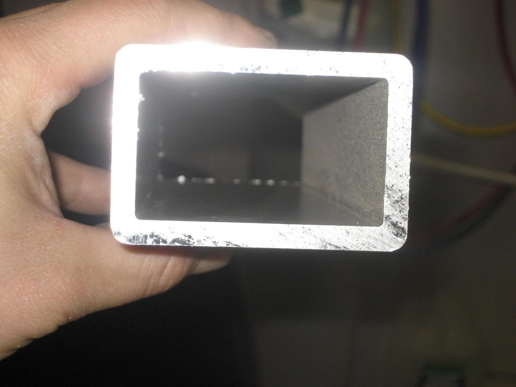

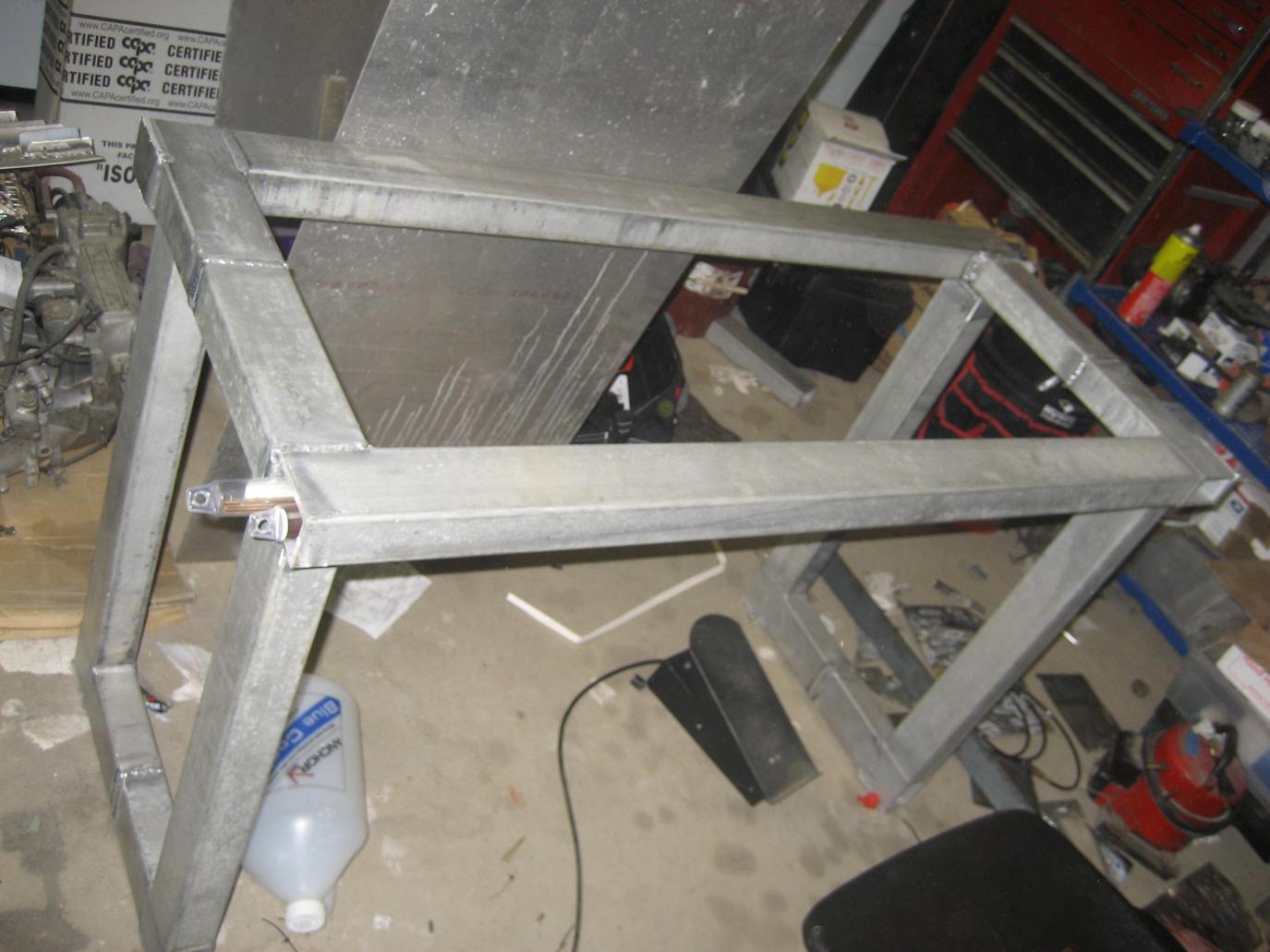

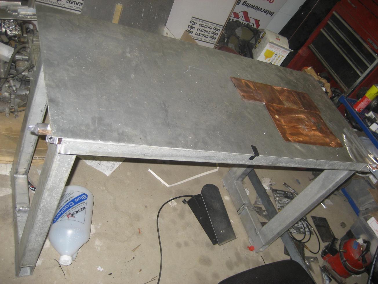

    I was wondering what type of welding tables everyone uses? If you made it or bought it? I made mine out of aluminum to be light so if I had to move it would be easy. I made it so beefy out of 1/4" 2" x 4" aluminum the beast weights about 80 pounds so it defeated the purpose. The top is removable I just lay it on top. I have different tops I use. The most common is a 1/8" sheet of 6061 aluminum with a copper sheet to absorb heat and protect to table. I tell you this table is the best ground you could hope for. I have never had arc marks on anything I have welded. If I want to hammer or cut something I put a 1/8 steel sheet on top of the aluminum sheet.

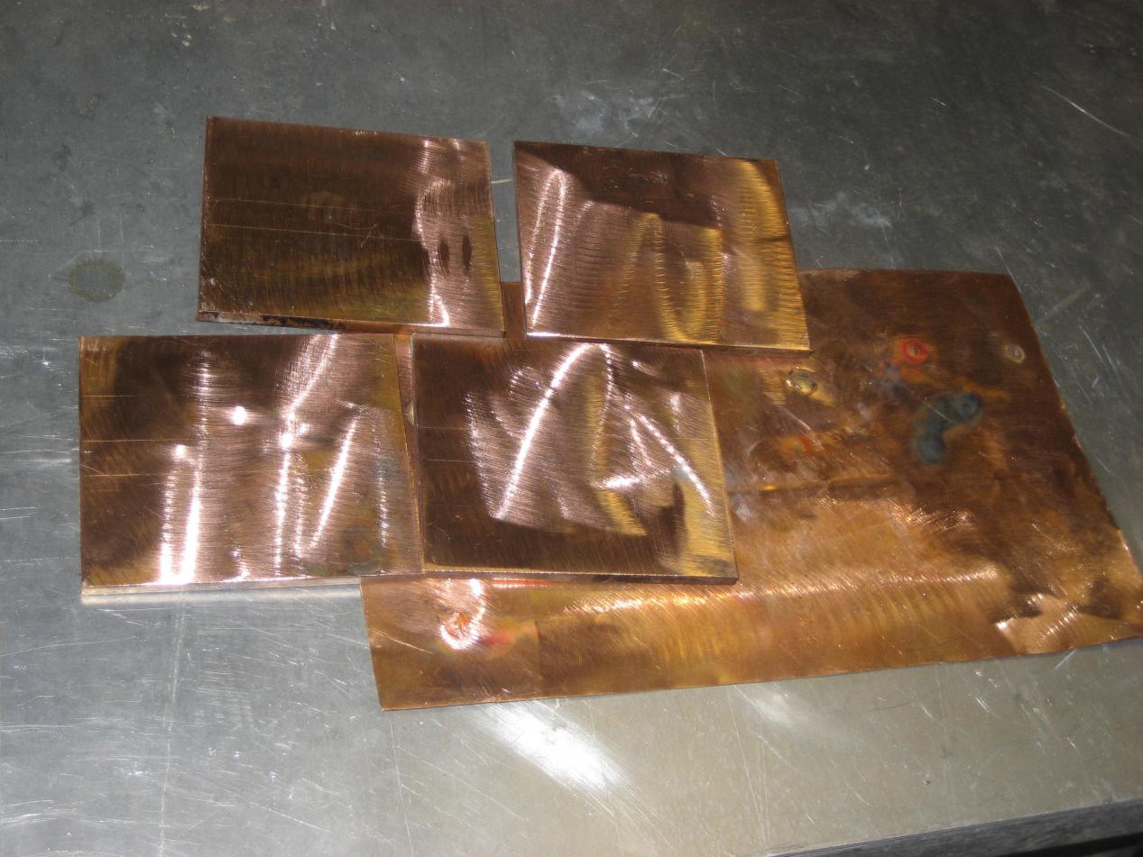

    Just about anything that will get you up out of that monkey squat position will do as a welding table, one of the best is an old sheet of ply wood sitting atop a couple of 2 x4's on sawhorses, need a grounding surface lay a sheet of some knid of metal on it....it is cheap and can be taken down and stored out of the way. One advantage of a wooden table is you reduce the possiblity of a zap when you rest on the wood surface another is,,,being able to screw down pieces of wood to help jig up or frame up the metal you are welding,,,,when you finish just unscrew the wood strips from the plywood,,,it's just an old piece of scrap plywood so you don't worry about making holes in it.

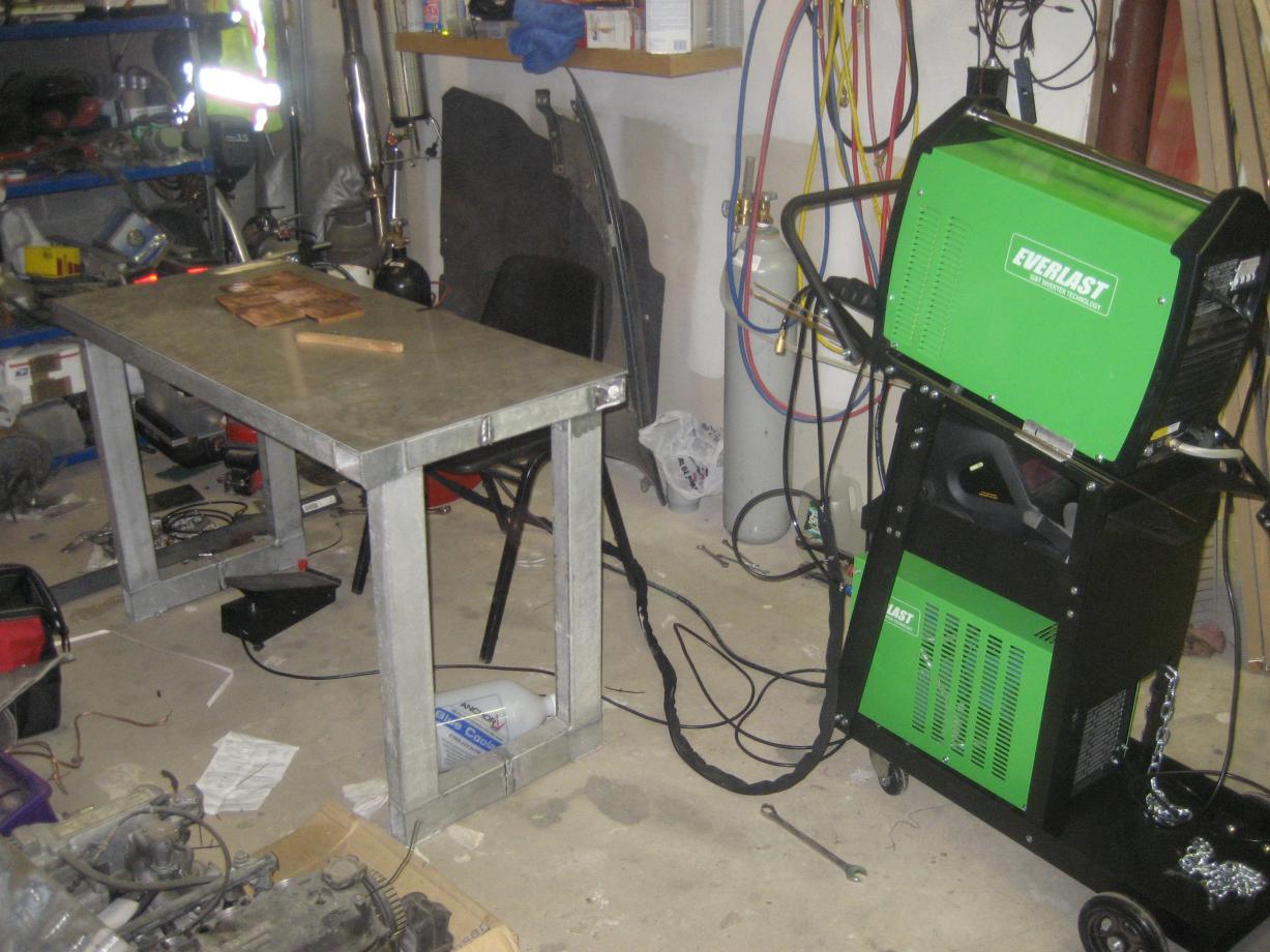

    The nice thing is I left to ends open and you can see in the one pic I use it for storing my tig rods. Also I use the ground clamp to hold the torch. I know I have to clean I'm a slob.

    Mine's just a cheap thin gauge tool cart that I got because I had to get welding. It has two really nice features for welding though: it's supported on a central pedestal and it's got a series of holes drilled along the edge of it's top. The central pedestal lets you spin the table & work around and you can get a clamp anywhere near an edge. The holes fit the torch's cup letting you set it down anywhere.
    Tough it is not, and I suspect the paint fumes are going to end up killing me. Also the cross beam that goes to the pedestal is forever in the way of the foot pedal or the foot operating it.

    Cippee. That's a nice stout little table. Is the 80lbs the frame or the frame with the top? Was the tubing rems, I see that the some are welded together to make longer pieces?

    Thanks. It just about 80 without to top. I stand in the middle and lift it when I have to move it. Since I got the parts from the scrap yard the pieces had little pieces welded on them. Instead of cutting them off I decided to just use it as they were since they were perfect 90 deg angles already. To cut the aluminum I used the diablo non-ferrous 12' blade on a sliding miter saw. It cut the 1/4" pieces like butter. You can see in the pic where I'm holding the piece what I nice polished cut it leaves. The only thing is the sawdust so to say is tiny sharp pieces of metal biting you all over. After the first cut I wore a face shield. Latter when I took of my jacket there was a piece of aluminum in it and cut my down my whole arm. I used the spool gun to weld the table together. I have to say I love using a spool gun. Once they are dialed in they are fun. I always set it on a piece of scrap of the same thickness as what I am going to weld because sometimes they can suck to set. I'm lucky the tips mine uses are notched so if the wire does burn back it doesn't scrap the tip.
