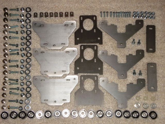

    that's a good price . working on my tracer this weekend so can make my plates to ride on the beams for the cnc table . got some pics so can run some prints to trace from .Click image for larger version.
ID:	6934 look fairly easy to make all ready have all the bearings and bolts and spacers.. bought a 100 roller bearings that should be enough lol
    I read your original email wrong, I thought you said you bought a 100 bearing roller. I didn't think you would have actually bought 100 units! LOL

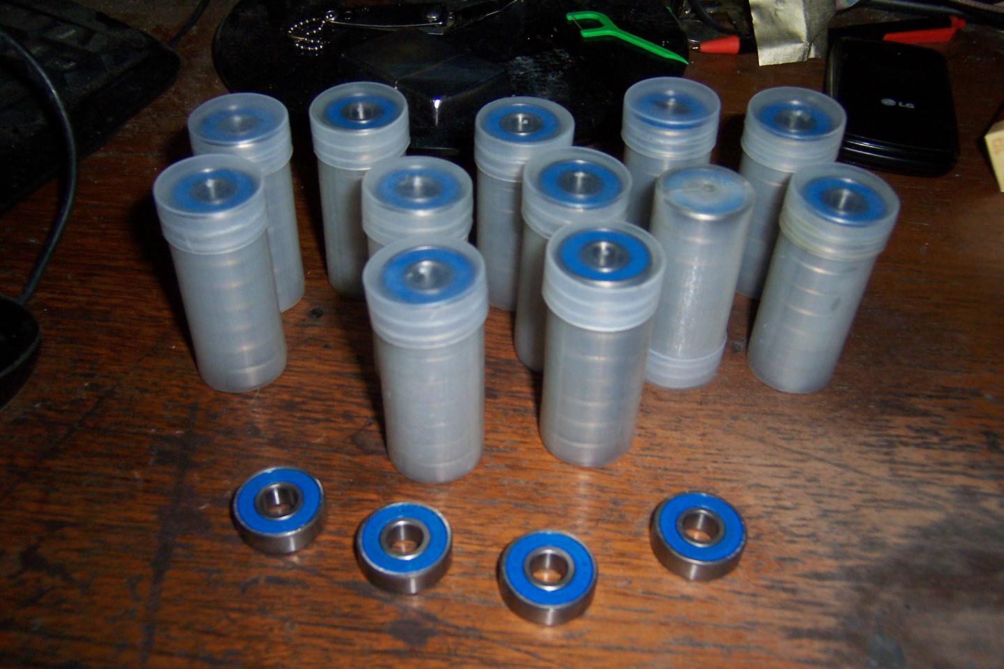

ID:	6936Click image for larger version.
ID:	6935 bought 100 of these roller bearings . got a 100 for 55 dollars
