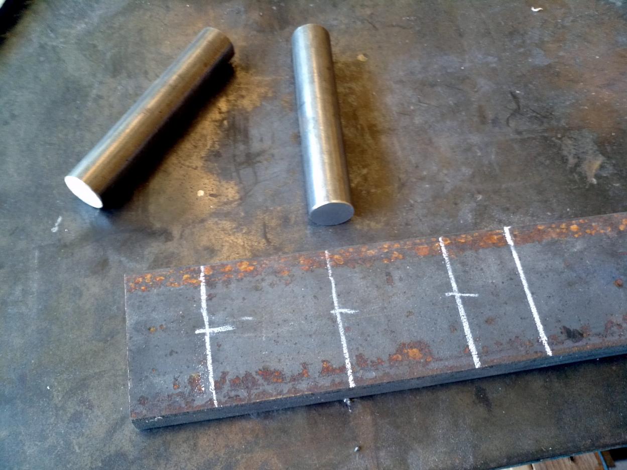

    I don't yet have the luxury of a hydraulic pipe bender, but I needed one the other day and this is what I came up with. I have a few bending forks I use when blacksmithing, but they are too small for pipe. I was doing 3/4 and 1" thin wall. Here's what I came up with. I started with some 3" x 3/4" steel flatbar. The jig is about 8" long overall.
    I marked out several spots for where 1" holes need to be drilled. This is to accept the 1 inch round bar you see in the photos. Each one of those was cut to 5 1/4"

    How well does it work? Does it kink pipe you are bending or does it make a smooth radius?
    Bill
    It doesn't give a flawless bend, you do see some marks from the pin when using on tubing. It does do nice gentle curves, anything more than that, and I'm sure you'd need a bigger die on the faceplate. I can post some pictures of the bends later this coming week if you are interested.
    bending solid bar is great on this jig.
