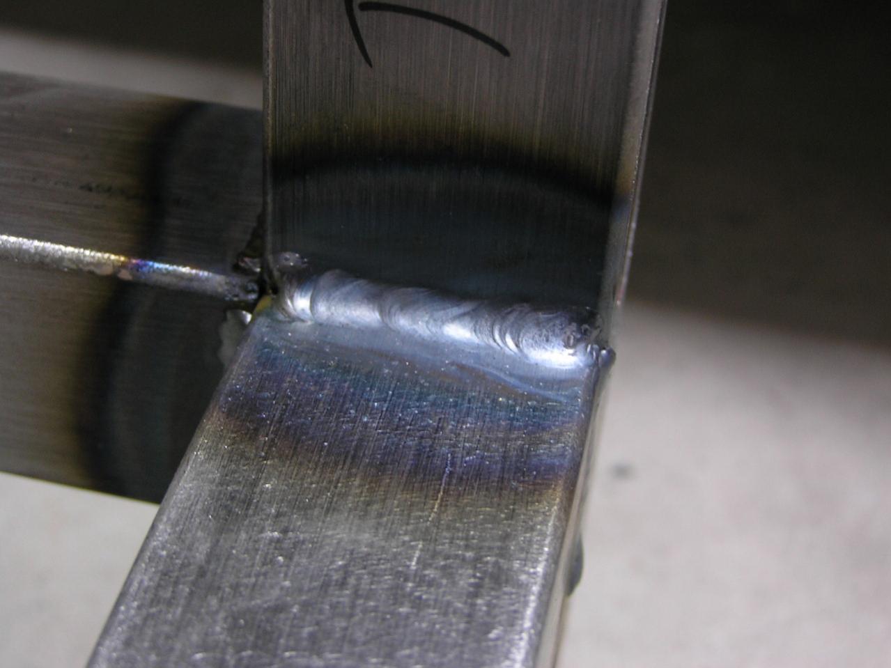

Well, everybody posts pics of their welding table, so here's mine. This was my first actual welding project since I got my 250EX. I spent a lot of time building my cooler, but there was no welding involved so it didn't count. I should say first that I figured that this would be a good way to get to know the welder and to try to re-learn TIG. I actually received formal TIG training, but its been a long time - I think Nixon was president at the time and they were calling it Heliarc. I was initially repairing chromoly truss work on light aircraft airframes and fixing cracks in inconel exhaust stacks.
Anyway, I didn't need a big table right now since I'm just piddling around with small projects. I scored a piece of 3/8" plate about 34" x 27" for $30 so that became the right size.
I had a bunch of 1-1/4 thin wall (1/16") tubing from an old fence we took down, so I used that for the frame. Its a little light for a welding table but I figured since mine is small it would work OK. I decided to bolt the top to it, so I got some DOM and cut some bushings and tacked them in place on the ends of the top rails. This way, I can crank down on the bolts without crushing the tubing.

Still got a ways to go with my beads, but I was able to stick it together.
