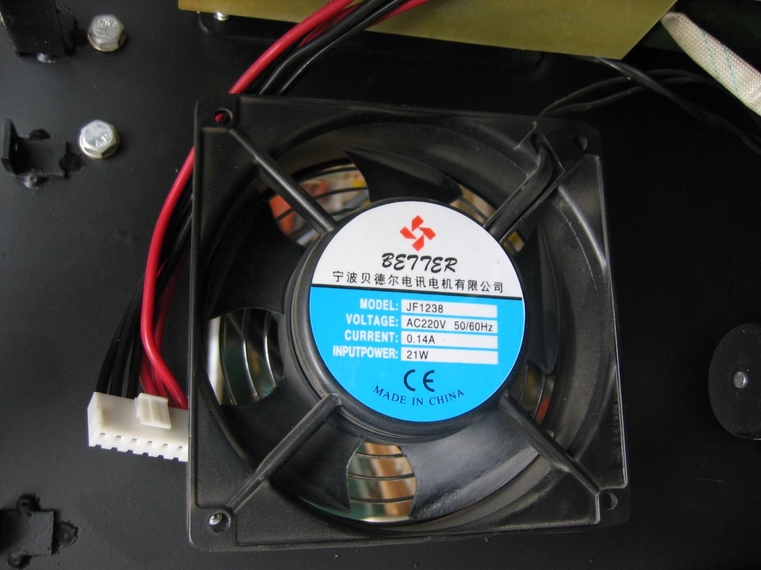

    My super200P has two of these fans, side by side, and they really seem effective, and quiet. They are on all the time when the power is on. Although they are not very loud, they seem to move a LOT of air. It is possible for some fans blades to be molded to that they move air more efficiently, while other fan blades simply "beat" the air and make lots of noise without moving much air.
    FWIW, they seem to be a lot quieter than the fans in the newer IGBT everlast machines (at least, the 250EX that I have used in person, but also seems like other IGBT models are just as noisy.)
