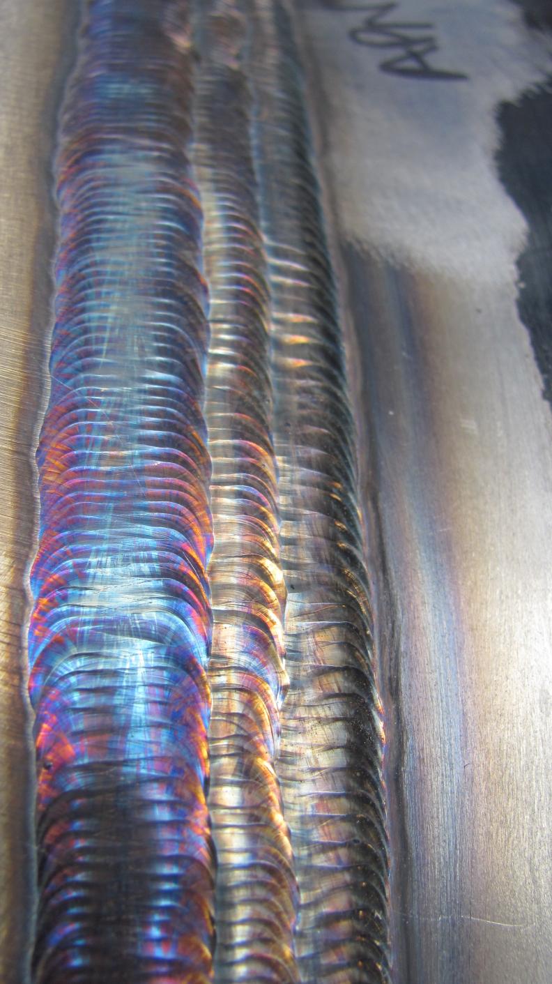

    I do not know why all the notes have been erased. The comments are light compared to what you would receive in the field if you showed up for a job and everyone found out you were a beginner. My work passes less than 70 % of welders, many with 20+ years pipe welding all over the country. Here are a few pictures I took in the shop of a hot tap mockup.

ID:	5923Hooda, I suggest you find someone who knows what they are doing and they can help you with the proper settings and techniques. With some practice you will become more consistent but it will take a lot of hood time. I attached the pictures to show the type of consistency that is typical of a professional welder.

    That's some awesome welding. I don't think I'll ever be that consistent.

    It almost looks like the AC balance is turned more toward AC too much electrode positive dialed in. One thing about tig welding you can have one dial turned the wrong way, and go from zero to hero!
    I will say tig welding with the power arc 140st has helped me out a bunch. Sometimes less is more.
    I will say something for Hood a. It takes a man to ask for help. When I call support I always check to see if I made a mistake first. I have watched too many people raise hell and blame a company for their mistake. Sometimes you got to lay your pride down and ask for some help.
  8. #28
    I would assume he is using DC on that since it is steel.
  9. #29
    I'm sure he does, I'm saying it looks as if he is off on one of his settings.

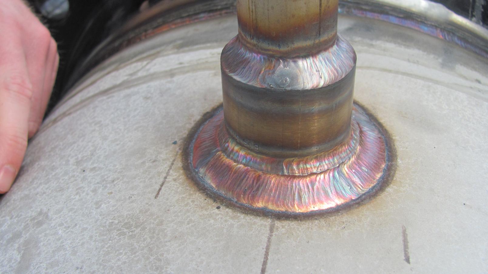

    It looks like you're trying to maintain too much puddle with too little an electrode and too much power and end up chasing it around. Shorten up the electrode some so you can drag the cup and keep the puddle small enough it doesn't snag the cup on several pieces of scrap to get an idea of how to work very close and cool. I highly recommend the weldingtipsandtricks site for great close-ups of TIG at work, too. Your welds look 'noisy'. TIG should be very quiet. Mill scale and rust is a killer for TIG.

    So far, this appears to be the best description of what I "feel" but don't know how to diagnose and correct. I will try to use a lower power setting on my next welds. Thanks for the tip.
    The part in this thread was just a one-off for my trailer, and it was all 1/4" thick, and I considered it to be strictly practice, an opportunity to get some hood time, and with me as the customer, things looking as bad as they do are something I can live with.
    Now, next on my agenda is a table of sorts that I need to build. The entire table is 1/8"wall, 2"x2" square tubing, and the majority of the welds will be tee joints, just basically getting one tube butted up and perfectly squared up to the other, tacking in place, and finishing up after I have 5 or 6 tacked up. I have literally hundreds of these to do, so it's in my best interest to get really good at them, really fast. I have a PILE of short pieces to practice on before I go to assembling the first table, so that means that I have plenty of room to make my mistakes, and get the process nailed down. The plan is to experiment with pulse, different electrode sizes, tip chapes, cup sizes, etc. I would really appreciate it if guys with experience would maybe give suggestions on where they would start out at, settings, electrode size, etc. and whether anyone would consider this to be a 2t/4t situation vs. foot pedal. I prefer the pedal, it's just I think I might want to get good with the switch for those times when that's the only option. Thanks

    115 amps, 3/32 tungsten, 1/16" filler. I'd leave pulse off. Keep the heat a little biased to the long tube side rather than teh end of tube side.

    The first TIG job I had was welding together 2x2x1/8 box tube into tables. The tee joints are easy to do by dragging the cup and laying the filler in the joint. A slight back and forth will stack the little bit of extra wire it takes to complete the joint. I STRONGLY recommend the foot pedal at least for practice so you know exactly where it operates right, then you can set upslope and downslope and use a switch when doing so many of one thing. Everything you'll be doing is stringer beads unless your saw is crooked and you have to do some filling. The 'lay wire' technique is perfect for those tee joints and short flats.
    I can tell you from experience, build GOOD fixtures so the table is put together, with braces, as a unit. Otherwise something will pull out of square in spite of all you do!
    With hundreds to do (I only had half a dozen and was a machinist most of the time) I'd investigate a robot line. I have a cheap Hobard Porta Tig here if you need it.

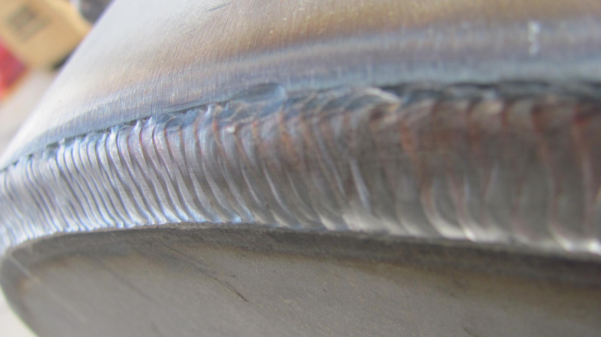

    Hard to tell from this picture what is going on; there might be some discoloration right at the tip; which if so could indicate inadequate post flow or some other shielding problem. Does your camera have a "macro" setting? (It looks like a flower symbol) That will allow you to focus better on very close things. (Generally, it's very helpful for taking clear weld bead, or other close-up detailed shots.) Glad to hear you are making some progress with figuring things out.

    Your big puddle is caused by the blunt tip, I think. Sharpen that dude til it sticks to a thumbnail and it'll focus the arc much better. It's normal for the tip to discolor some, but it's usually a case of too little post flow.
    He is welding on aluminum. It will naturally ball up.
  17. #37
    Quote Originally Posted by SimpleSimon View Post
    I believe he's welding steel.
